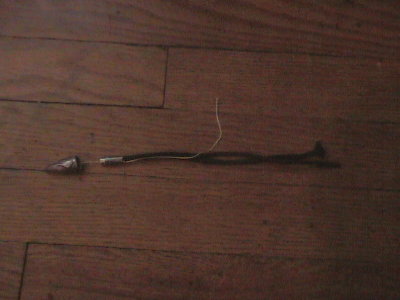

I would suggest threading a cloth tail through the hole (placing the center of drag behind the center of gravity) and firing at high pressures to stabilize them.
I've got a bunch of these at home; I'll make a video if you guys want.

Well, I tried attaching a tail. This is what happened.
I don't think I even need to upload the video: the tail kept it from tumbling end over end, but it still didn't fly completely straight (as shown from the shape of the round after impact).
I'm thinking someone with a better gun and a more subjective way of testing this should probably try it. I might experiment with different types of tails if I have the time.
