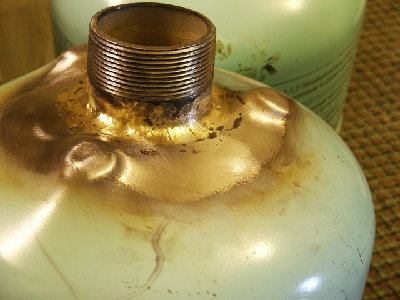

Tue Oct 13, 2009 7:44 pm
Welding or brazing is an option where screwing it together isn't an option, such as the valve built inside a propane tank.
Valve pipe brazed inside the tank
