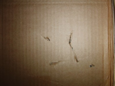

What was the approximate range...muzzle to target, and how reproducible were the results?sagthegreat wrote: I don't have the means to test this out from far away...
If it worked, 10/10 should hit head first at 30 feet.at 10 feet away, 9/10 of them self stabilized
at 20 feet away, 7/10 of them self stabilized
at 30 feet away, 5/10 of them self stabilized
Well, it's worth saying that you'll sometimes find projectiles with angled fins in order to induce spin (the first example to mind is the RPG-7), but it's not for stability.jackssmirkingrevenge wrote:air rifling doesn't really work
The thing is, I load then with the "drill" end first, which is lighter due to material being taken out to form the drill pattern, and they all hit with that side going into the targetjackssmirkingrevenge wrote:If they appear stable, I would wager it is more to do with the nose heaviness
