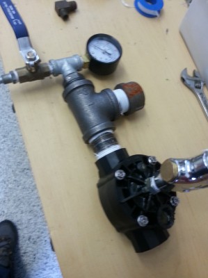

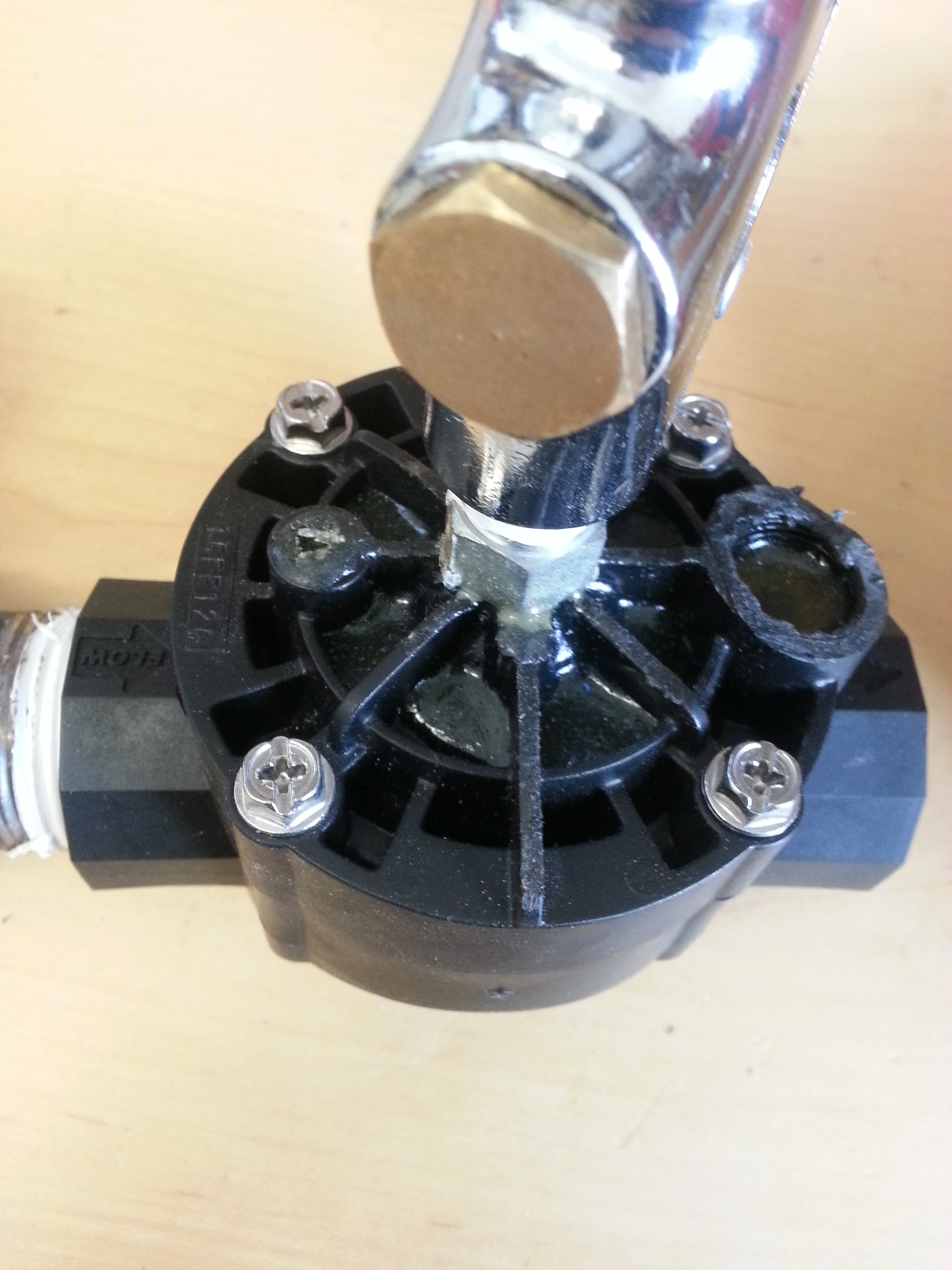

Here's some pics.. Muchos thanks for the help
Filling station with sprinkler valve and trigger. Cap on where the piston housing normally is.
Close up of the valve. Mixed way more epoxy than necessary when modding so I just slapped it on top of the housing for extra support.
Fri Feb 28, 2014 3:36 pm
Some times the adapter will be scewed to far in and be touching the diaphram holding it open...

Fri Feb 28, 2014 4:06 pm
I tried to make sure it was only in enough to be just poking through the plastic, but if it is in fact too far I guess it's garbage now lol... I'll try putting air through the blowgun tonight like jsr suggested. That doesn't work it's looking like a ball valve trigger for now

Fri Feb 28, 2014 7:28 pm
Got it working!! For some reason it wasn't equalizing, so I put some pressure into the top half while putting pressure into it like normal. After that it seemed like the diaphragm had been "freed" and now it works great. Thanks again all!
Sun Mar 02, 2014 8:57 am
Could it be that some epoxy seeped through when you were filling the solenoid pilot hole and was keeping the diaphragm from sealing?

Sun Mar 02, 2014 11:07 am
I double checked that it was totally cleaned up, but maybe running air through it cleaned it out. It just seemed like it just didn't want to equalize for some reason
