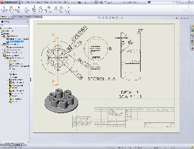

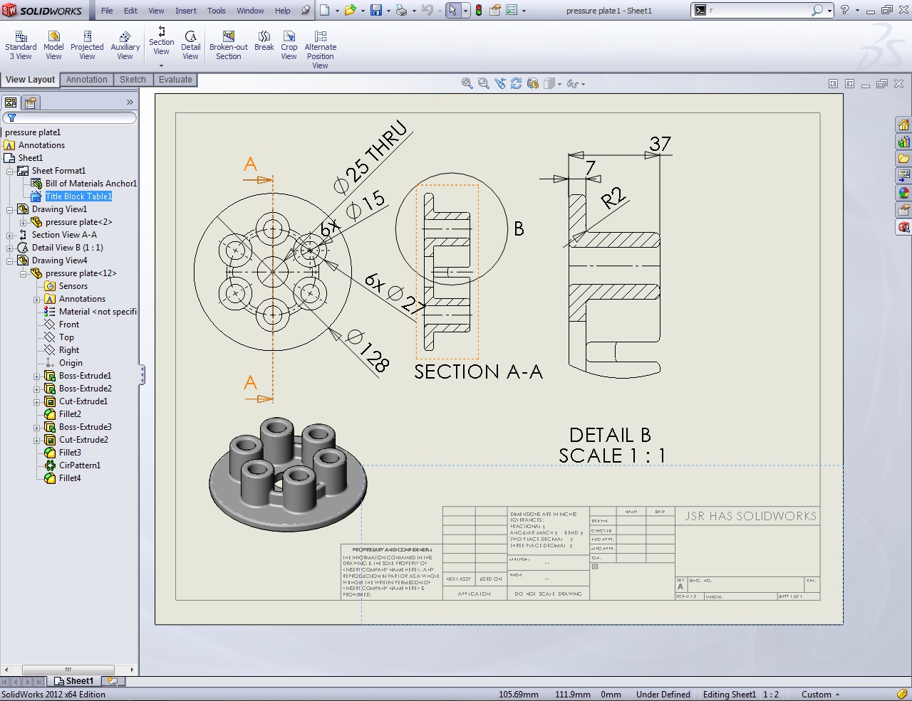

Haha dewy's got competition now
what licence did you buy? I'm lucky I'm a student, I can get it for free
... but this is for a commercial venture so standard license it is, costs an arm and a leg but from what I've seen so far, I can see the benefit

That looks like training not a real jsr design.
It was part of the tutorialal-xg wrote:Oh and hidden tangent edges, I must approve

Yeah it's the first tutorial, only just installed it so don't expect original renderings just yet.That looks like training not a real jsr design.

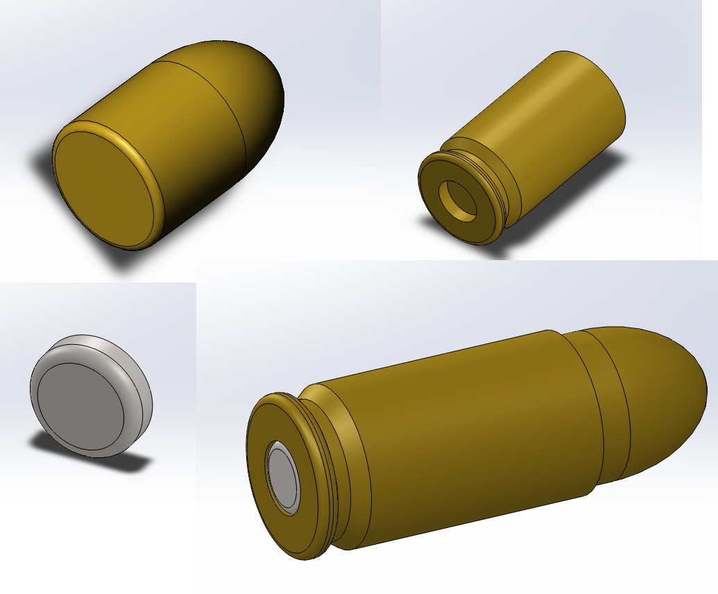

Edit: Had a bit of a play, here's my attempt at 9mm round

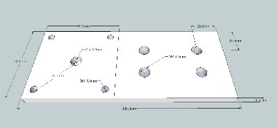

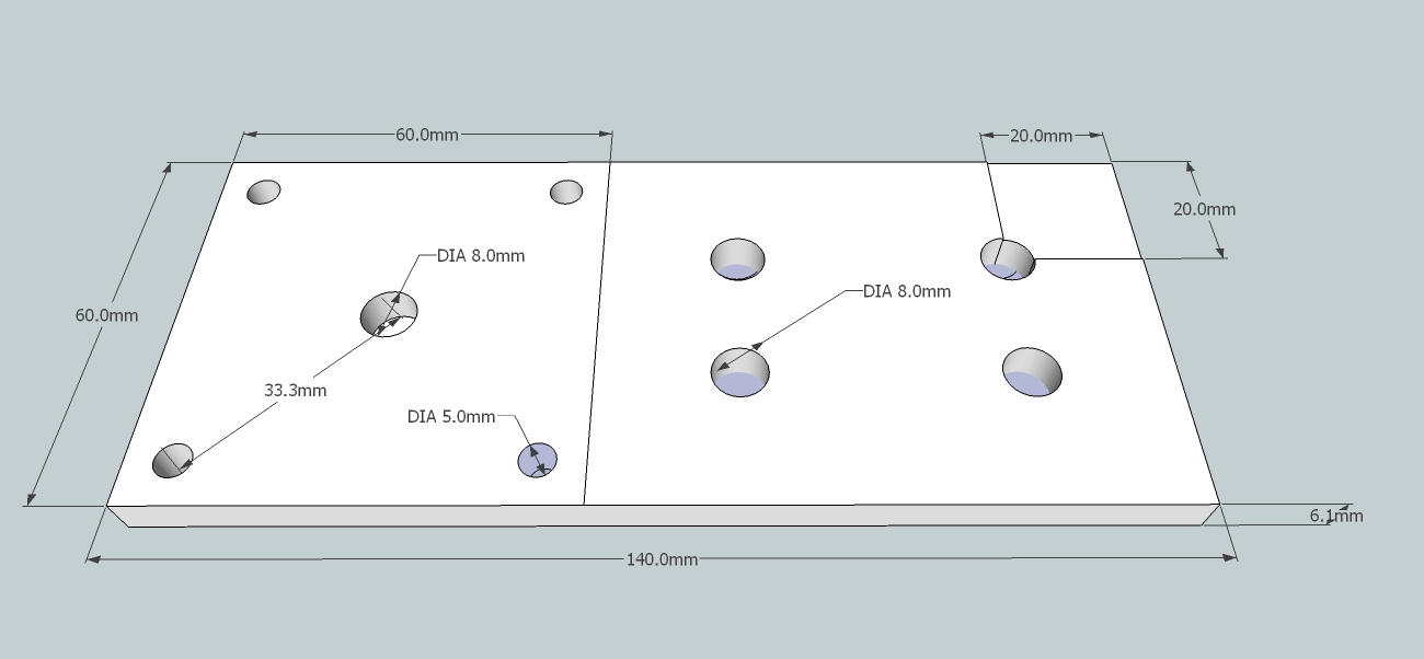

I need a three motor mount plates milled from 1/4" aluminium plate, any takers in the group ? Sketch attached.
Edit: The milling job is paid of course, sorry that wasn't stated up front.
