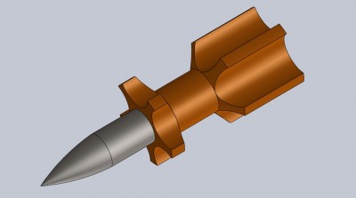

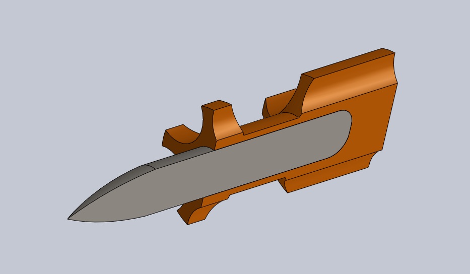

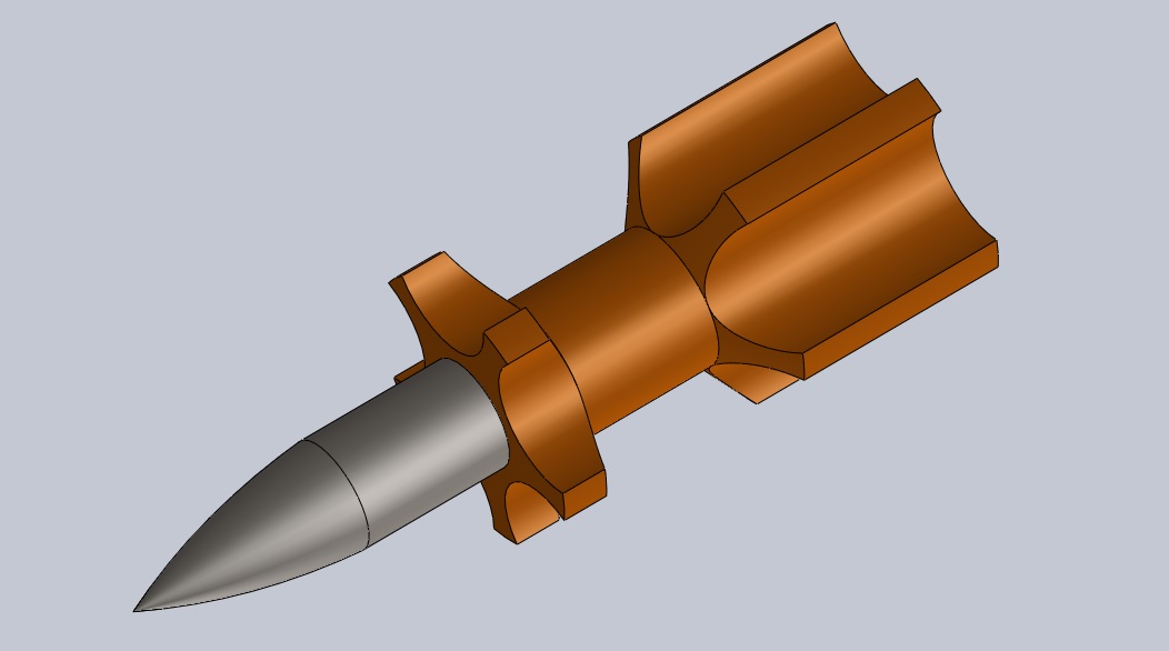

Sun Dec 28, 2014 12:04 pm
Finally got round to installing Solidworks since changing computers, made a model of a typical dart from the last batch:

You know, if you're bound and determined to never learn how to use ANSYS, you could use Solidworks' built in FEA to do a stress analysis of the darts. Find the maximum acceleration of the dart in the barrel, then model the dart upright (nose pointing up) under gravity equivalent to that acceleration, with the base being supported by the appropriate pressure and the (small) difference being taken up by weak springs (technical term, look it up). You'll want to do this as a 2-D axially symmetric simulation, which will reduce the computational requirements while conveniently doing away with the other unnecessary degrees of freedom.
Are those aluminum sabots with HSS penetrators? How did you get that profile on the bottom of the hole? Endmill with a large corner radius?
