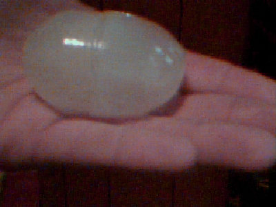

an aerodynamic ice slug

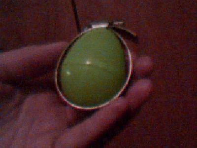

Just open the egg, sumberge it in liquid, put on the fastner, then stick it in the freezer.
for 1.5 pvc barrels
I fired off an ice slug and when they fit just right they go flying WAY FARTHER than potatoes! I would suggest easter egg ice slugs to anyone who is looking for serious speed, distance, and accuracy
Its easter and plastic eggs can be easily obtained. plus they don't leak with the fastener on
Ice Slug.
Ice Slug.

i found that using easter eggs as a mold for ammo is way better than the cylinder mold.
use the regular sized eggs. not the big ones and not the more narrow ones.
