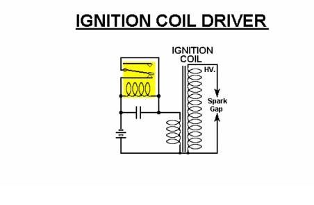

I have found an excellent circuit to use as ignition for anything from a standard combustion to a high-pressure hybrid. It uses an ignition coil, an automotive relay, and a capacitor. I wired it to make a Jacob's Ladder and it works quite well. [youtube][/youtube] I found the circuit diagram for it but it was incorrect so I gladly corrected it.
It's been a while since I've been on. I've been a little busy with life to keep up my hobbies.
This is the corrected diagram. I found the original on Instructables.com

Good to have you back onboard, it's a reliable circuit, but some will say it's too bulky. Motorbike coils or lawn mower magnetos work well, and are smaller.
Just don't touch the output, very rough.

If you can't find an automotive type cap, a sweep mylar or polyester cap from an old CRT monitor will do the job. Find a value between 0.1uF and 0.47 uF rated at least 200 Volts. Don't use an electrolytic in a can. This cap is a dipped cap often orange in color.
Most ignition condensors are in the 0.24 to 0.35 uF range.

I used capacitors from TV's and CRT Monitors. They are all rated to at least 1.2kv. I checked each one and ended up tossing dozens aside for later use. I plan on trying out a few different, smaller setups. Such as using a "tazer" made from an audio transformer added to a HV rated multiplier. This was more intended for larger builds. This could be used in something like this.

Aka a "buzz coil" driving an ignition coil. Similar to the Model T ignition system (linky), and traditional points based automotive ignition systems, as well as early radio transmitters.

It really is an amazingly simple device. It works every time. It's also fun to tinker with as a HV power supply. I was actually playing with a relay I had while wondering what I could do. Crossed random wires and it buzzed which, at first, scared the holy crap out of me. I opened it up to find out why it buzzed and then I youtube'd the idea. Seems very common. Only issue is how fast it sucks through relays if you aren't careful too let them cool. Any ideas on high voltage toys using about 50kv AC?
