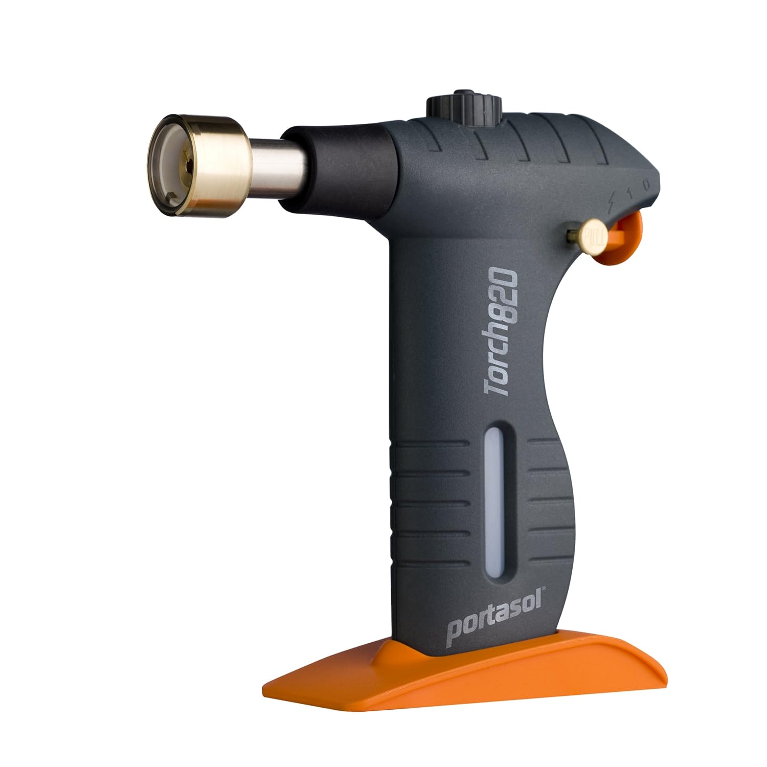

Also, for future reference, is it possible to solder small copper pipes (like 1/4 inch) to fittings using a Butane torch similar to this:
I read on some plumbing forums that the maximum size that can be soldered with those is 1/2 or 3/4 inches. Is this true?
ramses
Posts: 1679
Thu Dec 27, 2012 11:36 am
Probably. Although, in my area, propane is at least ten times cheaper than butane. The big flame from a propane torch will also heat the pipes MUCH faster.
