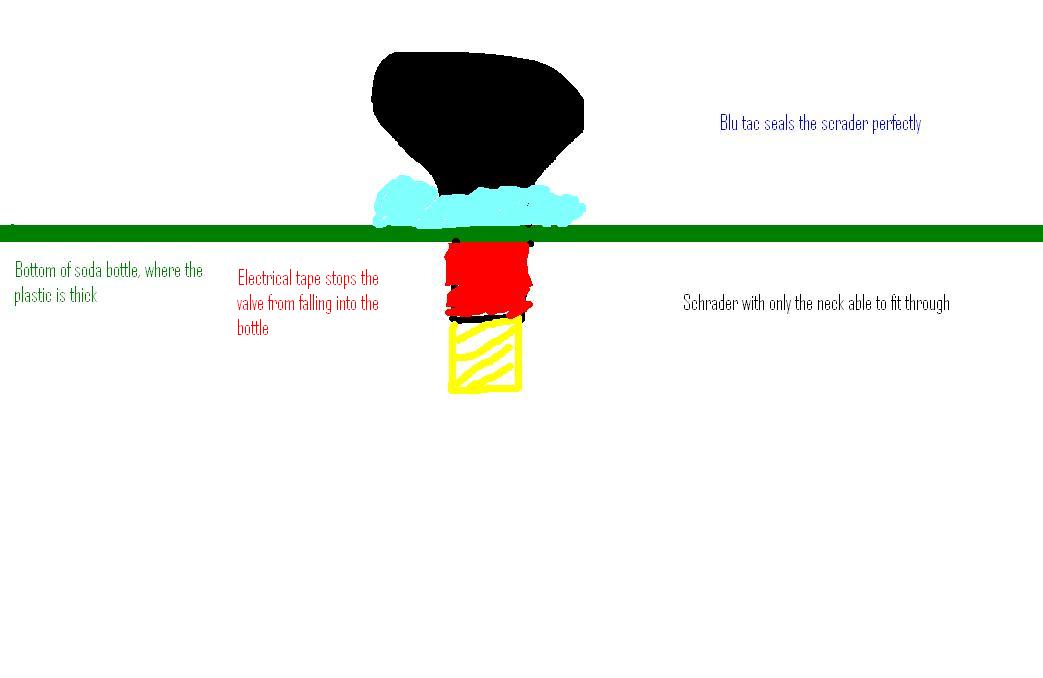

Before you use a bottle, fill it with water and then pump it to 100 psi. If it shows no sign of streaching or bursting it should be ok to use. I would recomend you stay at 80 psi just to be safe.
Get a tubeless tire valve from a tire shop (the kind with the big rubber bulb at the end) and drill a hole in the thick plastic in the bottom of the coke bottle. Only drill the hole big enough to fit the stem of the valve, it should be impossible to get the bulb through. Put some blu-tac near the top of the valve's stem and then lower the valve through the neck of the bottle and drop it into the hole (I used a bit of wire to do this) Next, pull the scrader so that the blu-tac makes a seal, then wrap the exposed stem of the valve in electrical tape (it stops it falling into the bottle) This should hold with no leaks to a least 100psi.
Oh and when I went to the tire store and asked for valves, the guy gave me 2 valves for free!
Here's a diagram
tire valve.jpg (33.33 KiB) Viewed 5109 times

I made something similar to this. I had a shrader valve just like in the diagram above and i drilled a hole into the lid of the bottle and simply pushed it in so it was sitting between 2 little notch type things on the valve. I didnt even use any glue/epoxy and I pumped it to 90psi without leaks. Even without glue I had to cut the lid to get the valve off so I could use it for something else.
Airbeds... so many different uses
