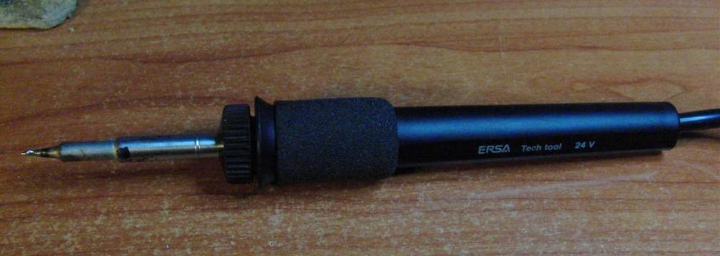

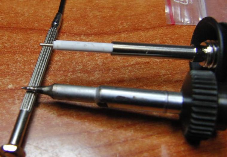

Here is the soldering iron from one of my ERSA soldering stations, you can see the thin element and that is measures the temperature only a few mm from the tip.
Because of this its very fast to regulate the temperature and it heats up from room temperature to 280°C in 12 seconds.

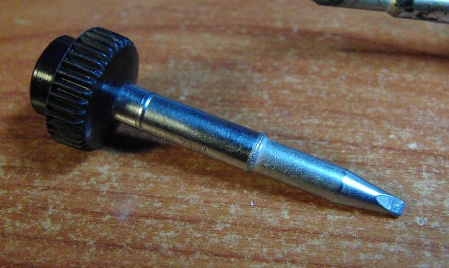

Another bigger chisel tip.

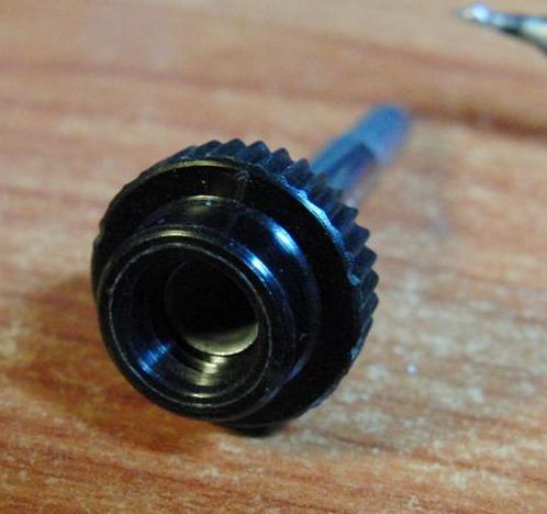

The element and tip
The element and tip

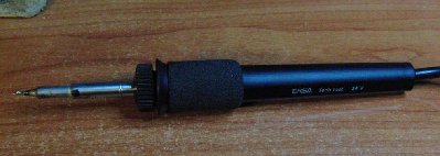

The soldering iron
The soldering iron
