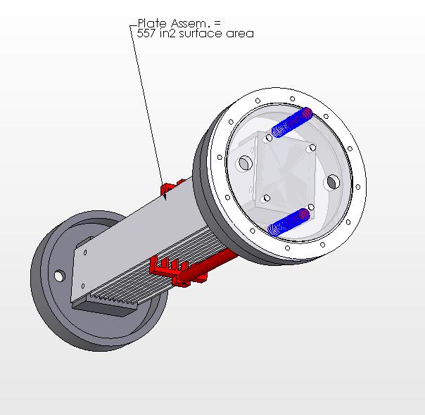

Jeeperforlife wrote: Each plate is 3" X 12", there is 12 plates and I have 12 more for another cell.
I can't determine your plate configuration from the photos. How many +, - and neutral plates do you have. Contrary to popular belief, "neutral" plates do very little if anything for gas production.
Also the watter turns very dark after less than a minute what is this caused by? All metal on this is 316 stainless.
I use distilled water (1 gal) mixed with 6oz of concentrated limon juice. The electrolyte stays clean for a long, long time. When I used tap or well water, the electrolyte turned to thick, brown mud in less than 1 minute.
This is a unit I built 2 years ago. It's about the same size and configuration as yours but, it has 6 positive plates, 6 negative plates and zero neutral plates. It produces 3 liters per minute at 12volts / 13amps and produces very little heat. The electrolyte never boils.

Every other plate is positive and every other is negitive. I am not sure what a nuteral plate is. the stainless allthread goes through every other plate the plate it doesnot go through has a notch in it so the washers don't contact it.
Sounds like I need to try your electrolyte solution and your tap water was doing the same as mine.
I tested it with my mutimeter and there is not a short anywere in it. My car battery charger is putting out 14 volts when not connected and 8 volts when conected.
I have enough room on the allthread for more plates so I may just add more plates to this and not build another one.
A neutral plate is one that's not connected to + or -. They just ride along in the case as dead plates. Some builders think neutral plates work miracles when in fact....they do nothing. Plate spacing is very important for gas production at lower amps. Try to keep your plates at a max separation of .050"
