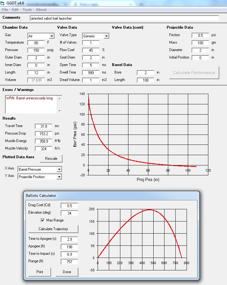

Here's an example modeled in GGDT with a 9 foot x 2 inch barrel and 1 foot x 2 inch chamber running at 150 psi:
As you can see, the theoretical barrel pressure drops below zero before the sabot leaves the muzzle, meaning it would have started to decelerate. Assuming your bait is a sphere, you would still range several hundred feet.

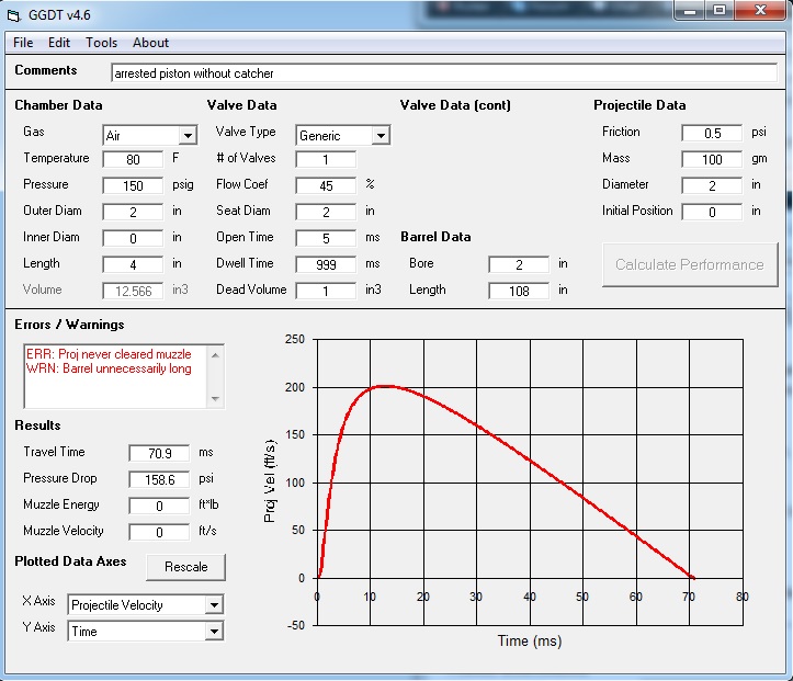

Here's what you would need to stop the sabot in the barrel without a catcher:
I kept the same specifications bur reduced the chamber volume from 12 inch length to 4 inch length. As you can see, the sabot never exits the muzzle, but within the barrel itself it reaches a peak velocity of about 200 feet per second, and this would be the velocity imparted to the bait.

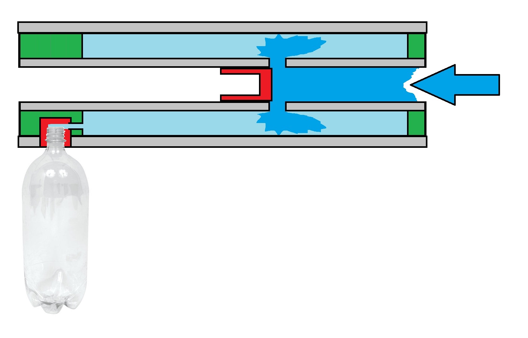

edit: a way to apply the concept without having an excessively long barrel is to port the barrel half way through and fit a sleeve over it - this will greatly increase the barrel volume, and therefore gas expansion and sabot deceleration, without needing a ridiculously long barrel.

I really like the idea of adding the 4" pvc as a sleeve over the 2" barrel. How large should the ports be? How many ports.
As many and as large as possible, but not exceeding the length of the sabot. For this concept to function, it is essential that the air in the barrel remains as contained as possible in the sleeve:
Is the sleeve sealed at both ends?
For the same reasons articulated above, you need the air not to escape the sleeve.

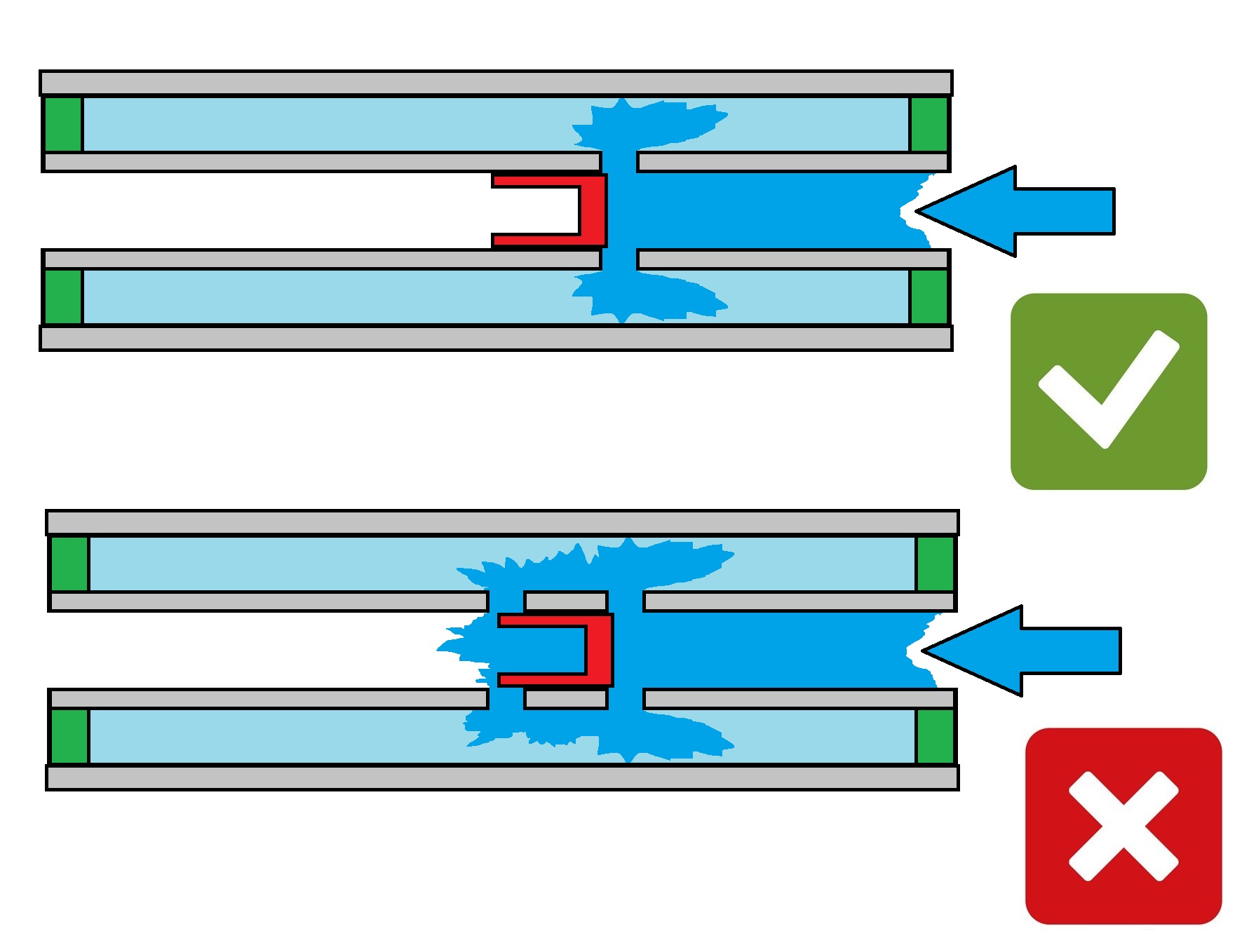

What would happen if I only drilled ports in the 2" pvc and didn't use the sleeve?
The air would exit the barrel and stop accelerating the sabot, but since you haven't created a "suction" effect, it would not be trying to brake the sabot.
The best way to illustrate the idea is to press your finger against the nozzle of a syringe and pull the plunger. You'll note that there is a force trying to push the plunger back in, because atmospheric pressure is greater than the pressure inside the syringe chamber - this is the effect we are after. Otherwise if you only rely on barrel friction, you're going to end up with a ridiculously long barrel that is completely impractical.

That being said, all you want is the spare volume. You could for example epoxy a couple of bottle caps into the sleeve and when you arrive at your destination, screw in 3L bottle et voila, tons of spare volume that you don't have to pack in your bags:
edit:

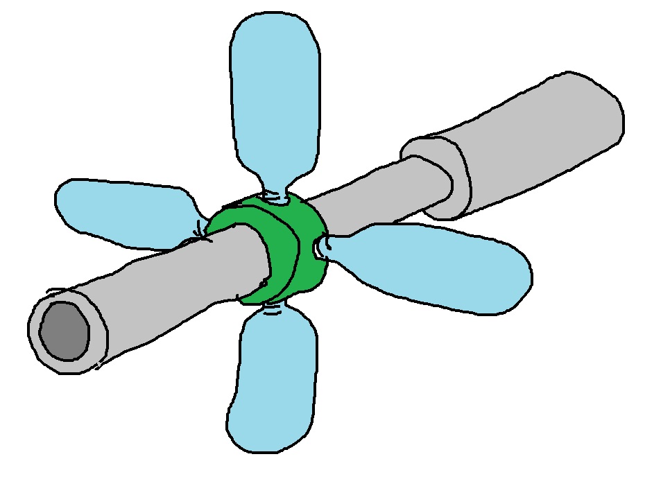

Screw having a sleeve at all, why not fabricate a central hub that you screw several 3L bottles into?
Looks a bit silly but pretty is as pretty does, you have your expansion chamber cheap at destination without eating into your baggage.
