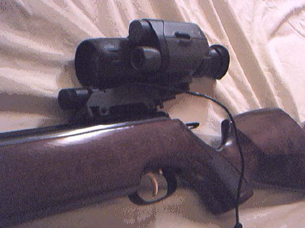

Tue May 15, 2007 10:40 pm
have a look here ;)
I have me one of these mounted on my HW97K:
Weihrauch HW97K NV closeup.jpg (34.71 KiB) Viewed 3875 times

jackssmirkingrevenge wrote:have a look here ;)
that scope looks so nice jack :D
Wed May 16, 2007 2:02 am
experament-u2 wrote:that scope looks so nice jack :D
It is, shame that zeroing the laser is such a hassle - ah well, good ol' soviet technology :D
