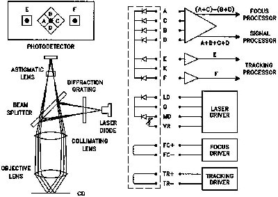

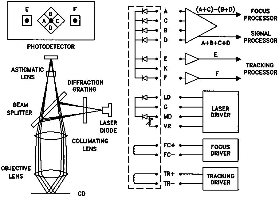

The four spots in the center are the main pickup and focus servo. The pairs cross corner from each other are mixed together. A cylinderical lens will make a round spot oval in one directon if focused too close and too far the other direction. The two pairs are compaired to provide the focus error signal and drive the lens focus coil to servo drive it into focus.
The two off center line spots are measuring the edge of the track of pits. As the beam starts to hit the edge, one diode gets a strong reflection while the other moves onto the row of pits. These two are for tracking and make a high speed line following robot out of the device. The high speed component drives the lens to track off center discs and the low frequency component drives the sled motor so the sled follows the row of pits from one end to the other. The tracking diodes are not used for signal detection. Only the center 4 are summed together to detect the signal endoded in the disc.
This page covers focus and tracking somewhat but does not go into the detals.
http://www.gadgetsguru.in/how/gadgets-w ... d&pageno=1
A service manual sometimes covers the cylindrical lens used for the focus servo and difraction grating used to create the three spots used for pickup. The center is for signal and focus and hits the 4 center diodes. The two side beams are skewed to the sides of the track and are used by the last two diodes for tracking.
Edit found a block diagram of the optical block including the difraction grating and astigmatic lens.
The center orientation of the 4 diodes is not important as long as it is properly oriented to the lens. The other pickup shown in a prior post shows the diodes oriented 45 degrees to this diagram.
Optical block of a CD Player
