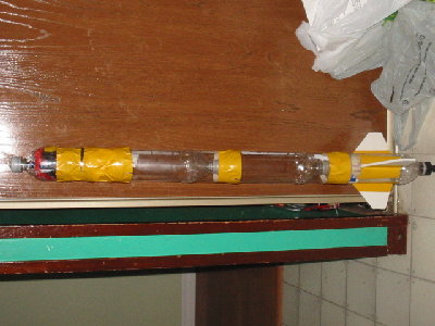

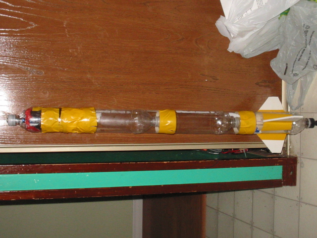

I used to make water rockets this is my rocket
xnt rnm ne z ahtbg
xnt rnm ne z ahtbg
Very nice! Roughly how high does that one go? Is it stable in flight? What sort of parachute system do you use?
