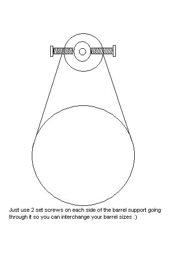

spudthug wrote:hehe..the only thing about barrel supperts is its hard to have interchangeable barrels...
edit: yea..thank god it wasnt directly at my water heater it probably would have went through
For interchangeable barrels you could drill out a bunch of endcaps or something, and adjust the ID of them to fit around different sized barrels. So then they could all fit into the same stock. If you had access to a lathe this would be really easy. Otherwise, it may take a little work to get them all drilled perfectly centered. To make changing barrels faster, you could use camlock fittings or modified air tool quick disconnects and just have the barrels slide in a piece of pipe or something, which could also be drilled and tapped for sights.
What do you use to stop the BB from rolling back into your valve? Some kind of pin or wire epoxied over the breach end?

Skywalker: Why not sleeve the copper into a larger tube and center it with an end cap? It would look cooler, and be more sturdy. Plus then you could bed it in a wood stock and it would look sweet. Plus the area between the barrel and pipe you sleeve it in could possibly be used to store BBs? The barrel would probably hold up, but it would be best to have it kinda clamped down on a stock to keep it from getting banged around.

Try this:

Adding a barrel support system so that the entire weight of the barrel isn't on that one fitting would be a good idea.
