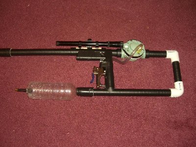

this is the first sniper rifle i made do you guys think its nicly crafted or should i make some changed to make it stronger or is it good alredy?

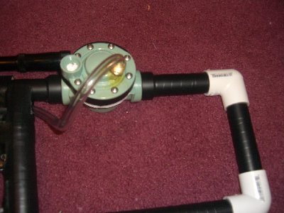

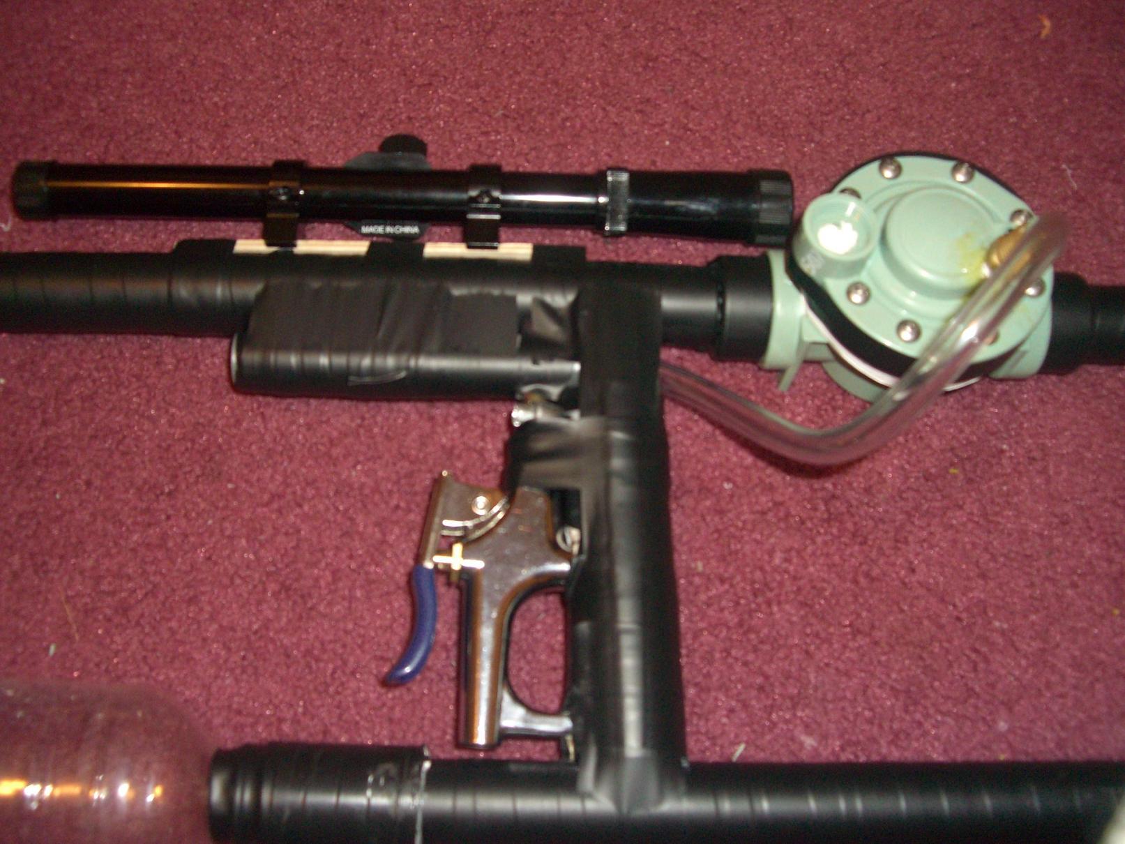

i used a modded 3/4 inch lawn geni sprinkler valve with 3/4 threaded pvc a blow gun valve

Is the bottle from a fizzy drink?
I would suggest making the barrel much longer, maybe 2 times longer. It will increase muzzle velocity by alot.

It doesn't seem all too powerful in the vid, but meh, who am i to judge, im only new

ohh that cuase i only did 10 psi LOL i could make more but it took to long so yea .. haha

I still fail to understand why in the hell people insist on using soda bottles as chambers.
Spend five dollars more and get the real deal.

\ to make the chamber, how many inches in diameter and leght should i make that chamber?PVC Arsenal 17 wrote:I still fail to understand why in the hell people insist on using soda bottles as chambers.
You could just extend the chamber you already have, just take off the bottle and extend that piece of pipe by about 2ft, then extend the barrel by 2 or 3ft.
I think were forgetting that all the joints between the bottle and valve count as the chamber aswell, so your chamber is a considerable size already, its just the bottle ruins it.
That looks like 3/4" pipe you are already using, so you could either stick with that, or go to 1 or 1 1/2".

im useing batterysjrrdw wrote:The bottel is to shinny, wrap it with eletric tape. Shoots nice from watching the video. I say nice job! What where you useing for ammo?

dont use batteries because they tend to spin in the air from my experience try making some darts or at least add a cone to the end of the battery
