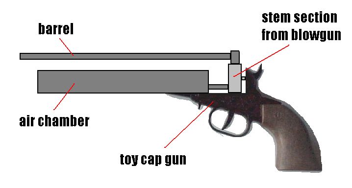

The best solution I can offer it this:
Find a good metal cap gun and remove the revolving drum mechanism, keeping the trigger and the hammer. Then tage a blowgun and remove the lever which you press with your finger. Hook up the blowgun to a chamber and a barrel, then fit the cap gun mechanism in such a way that the hammer strikes the stem of the blowgun.
The attached diagram should give a rough idea of what is needed:

I really doubt a cap gun mechanism has the force required to knock open a blowgun with a fair amount of pressure behind the valve.
I'm really not sure where Chuck isn't understanding that a hammer valve is not overly complex to make. Most of the versions today are simplified versions of the old system which had to be more complex to work with lower pressure. Plenty of material out there to copy.
Fri Oct 26, 2007 6:05 am
You can always beef up the spring or hammer weight.

i would like to see someone use a cap gun/blowgun for a valve and trigger it would be interesting to see, and it might allow you to get multiple shots off a chamber because the blowgun would reseal.
