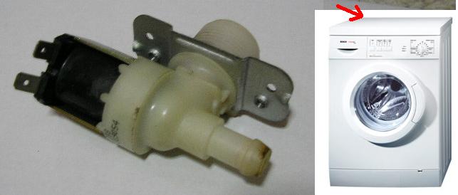

Where did your get that small sprinkler valve?
A good (and usually free) source of smaller solenoid valves is old washing machines and dishwashers, very suitable for BB barrels.
wm valve.JPG (24.38 KiB) Viewed 2543 times

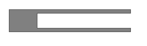

what would help is keeping the same length but drilling a 5mm hole down about 75% of the way to act as a tail

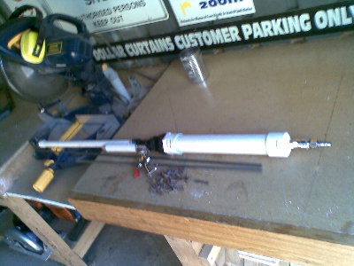

the semi-auto mechanism isn't working its not moving forward enough to cover the hole and the spring isn't reseting it so iv giving up for a while:(

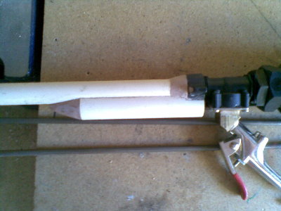

i have put this together
hand grip
hand grip
6mm barrel inside 18mm pvc
Wed Dec 26, 2007 10:07 pm
dyldo wrote:the semi-auto mechanism isn't working its not moving forward enough to cover the hole and the spring isn't reseting it so iv giving up for a while:(
Sorry to hear that - perhaps there is too much friction in the system?
dyldo wrote:through the projectile? or the barrel?
I mean the projectile, as per the attached diagram:
this way, the hollow rear will act as a "tail" and stabilise the projectile in flight.
