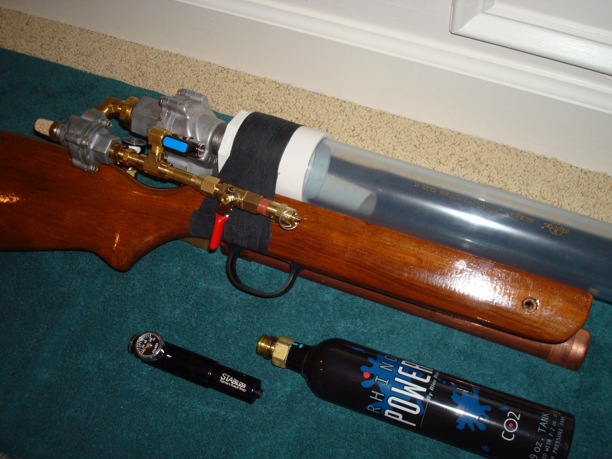

woohoo! got my McMaster order in yesterday, dry-fit the parts last night.
these are the next step in my progress with this prototype: http://www.spudfiles.com/forums/dual-qe ... 12691.html
showcase & details to come after this weekend build-test fest!
they're more purdy in person than these pics...
[edits: added GGDT file, leaking trigger assy. pic.]
[edit: added trigger assy mechanical picture (see "What A Find!")]
[edit: added barrel bracket & trigger pics]
Two alternate designs...  Obligatory foot in photo.
This one's my preferred design - will need to re-work the placement of the blowoff (which triggers the QEV's) to better connect to the gunstock trigger (however i decide to do that).
Nice thing about this design is that the trigger is still very comfortable whether mounted to the gunstock or not.  Also, the whole thing is still light enough to easily hold in one hand (and this one still has the oversized chamber still on it).

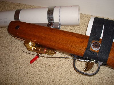

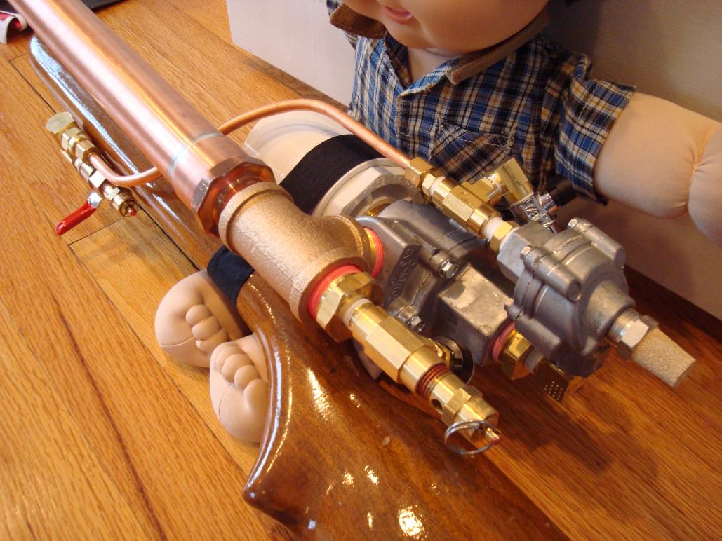

Trigger assembly on, but leaking from those darn compression fittings...   ...hello, old friend...

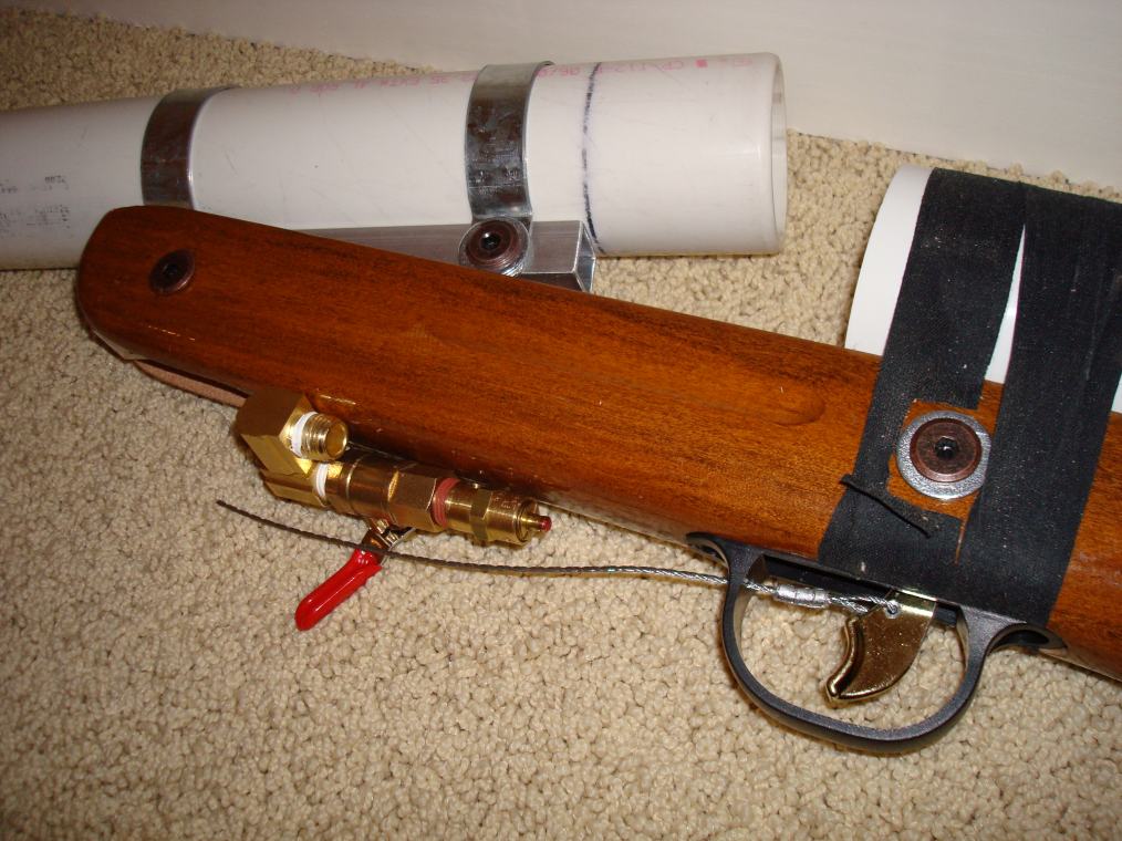

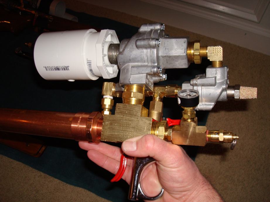

What A Find!!  <br />i was at the store to get flare fittings and found this for a trigger, including a way to connect it to the popoff valve (hadn't quite figured that part out till now).  hopefully it'll go together like i see it..!
What A Find!!

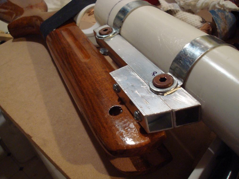

breakbarrel pivot &amp;amp; trigger in place.
breakbarrel pivot &amp; trigger in place.

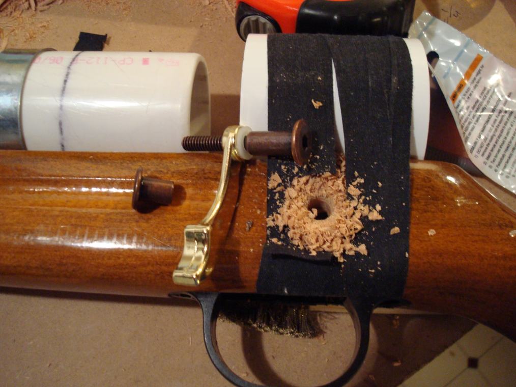

trigger about to be put in

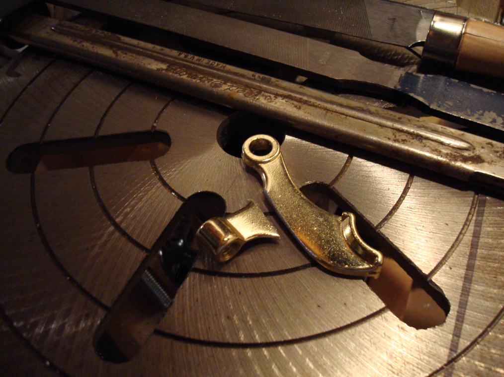

how i cut the trigger part (cut &amp;amp; filed)
how i cut the trigger part (cut &amp; filed)

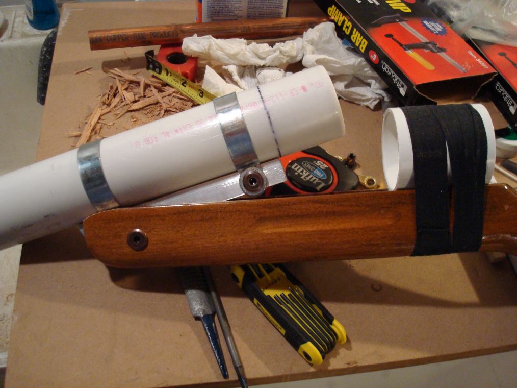

barrel pivot assembly in place

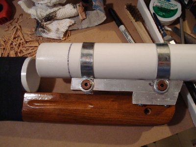

barrel mount pivot bracket

despite the high-pressure capable chamber, these rigs aren't for damage - they're for launching rockets at paintball games. copper for the chamber's just the lightest/cheapest option for me right now. PVC chambers not allowed.
the projectiles are 32g foam rockets at 160 fps max (for now - the local field is evaluating the max speed for this season - in other words, they're gonna shoot someone (volunteer(s)) at different speeds & stop when they cry... j/k you get the point...) some fields limit at 140, others 230. they've decided on 160 for the 1st scenario game this season.
if i can go higher later, i'll couple/sweat on more length...
oh yeah, and i definitely will be painting one of them - the one i'll be playing with. and, - don't smack me now - but i'll be painting the clear PVC barrel, too (i'll leave a strip along the side unpainted to see inside because i can never remember if i have one loaded or not!). i should have ~28" of it left over for later projects...
p.s. i did start to think about what V's i can get with a 1/2" barrel on it..!
p.p.s. oh yeah, i attached the GGDT model to the top post. it shows i should get the velocitiy i'm looking for at the pressure i want to run (90 psi with room to adjust up to 110psi - my self-imposed max). the GGDT model was calibrated with the prototype i mentioned in the top post.

thank yoyu - it's taking me a while to pull out all my soldering stuff & get down to fitting it together - gonna sweat the chamber right now & then fit together to check for leaks (and make sure my trigger assy. works).
the regulator is a Palmers Stabilizer. uit was free! no kidding a local paintball player had it xtra & gave it to me alnog with some other stuff - worked out great though because later turned out i had a different smaller low pressure regulator he was interested in so i gave that to him...
it's a "male" Stabilzer - if i were to buy another one, though, i'd get the "Female" Stabilizer with a LP Spring Kit ($79 + $10).
then you'd end up with a great (arguably the best) 0-300psi CO2 expansion chamber/regulator that screws right onto any readily available CO2 bottle.
