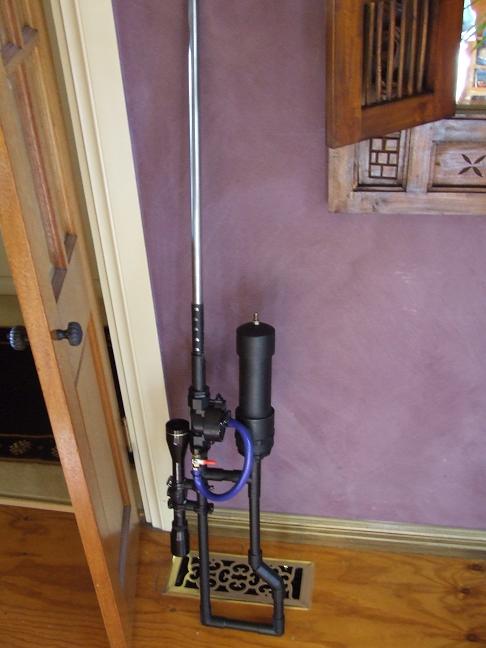

Hey folks!
Ive been lurking around Spud Files for the past few months now, so i thought it was about time to sign up and share my first completed Pneumatic.
This model has had many chops and changes but im finally happy with its design...

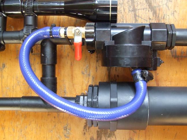

I built this because i wanted something different, as since i was a kid ive built combustions, so pneumatics were new to me. I found that using the 1/4inch ball valve for a trigger rather than a blowgun the sprinkler valve gets better air flow and opens faster (maybe i had a dodgy blow gun???)

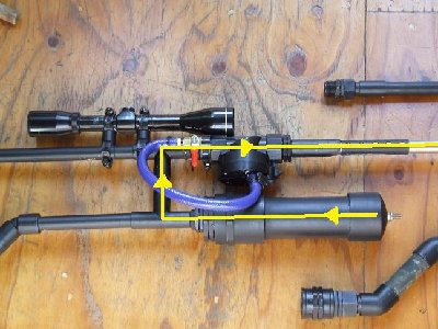

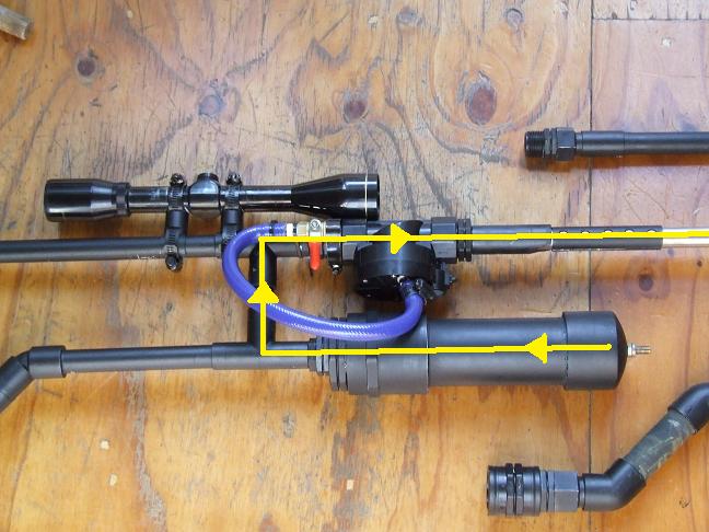

When i constructed the stock, i didnt want any airflow going through it so i blocked the two ends off by fashioning two small PR PVC discs that would fit perfectly inside the T pieces (see diagram). Once they were cemented in, the stock was fitted which created the seal.

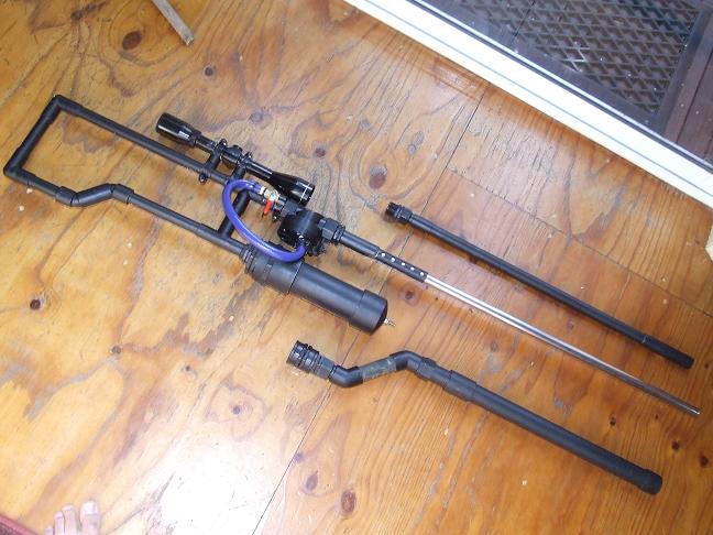

The chamber used to be much larger... im talking about 2ft of the 60mm PVC, which was pretty lousy unless i was resting it on something or using a bipod because it was so unbalanced. It wasnt until i experimented around a bit that i found i could get decent power with a smaller chamber like i have now.

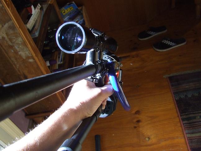

How is that scope to use, seems like it may be mounted a little too far forward. I'll give it an 8/10

good one for your first, but one small suggestion, whack in a barrel support, on that can be removed easily to put the thinner chamber in. im only saying this cos im sure theres a lot of pressure on that solenoid valve.

hey Novacastrian, i just noticed that in the 4th pic the scope looks way too far forward, but i think that might just be the camera. I set it to the most comfy position to shoot with... but i may be wrong, it might be too far forward.
CM, there usually is a support b/w the barrel and the chamber, i must have forgotten to put it back on that day when i was changing the gear around. Thanks for noticing though, i'll make a note not to forget that again.

I assume you have a threaded hose barb coming from your sprinkler vavle? It looks as if its coming out at an odd angle from the cap on your valve... is it just me?
