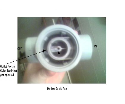

Ok so i read the original post and from what you have said, I have had the same problem with the first 1" valve i got. It is a 1" irritol valve and the guide rod is hollow and the where the rod attaches below the diaphragm into the body of the valve there is a hole on the output side of the valve that directly connects to the hollow guide rod. when i first modded the valve i noticed the same thing, the valve would not seal because the pilot side of the valve was constantly being piloted through the guide rod and out the output. solution, simple.... epoxy. i ended up mixing a little bit thinner batch of epoxy and dripped it into the hole on the output side of the valve and sucked on the guide rod til the hole was empty. i let that set a little bit and then filled the hole back up with a 1:1 mix of epoxy. once it setup i was able to close the valve under lung power. just something for you to think about. i can post pictures if anyone needs a visual.

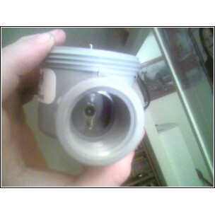

Ok so i decided to quit being lazy and take a couple pictures. And yes I know double post, but you will see that it is over half an hour apart and I need the spud bux.
looking into the body of the valve.  I have marked the in and out side the hollow guide rod and where it outlets to so you can get a whole overview of where everything is.

Looking into the barrel side of the valve, you can see the hole and the epoxy

The hole that leads from above the diaphragm to the outlet side (and through the solenoid port) is the exhaust hole. The whole area where the solenoid previously screwed in should be filled with epoxy. The hole in the middle where the guide rod goes through is also the equalization hole.

lol you have the same valve as me, i couldnt get it to work till i filled that rod with epoxy.
now it works just fine :D
