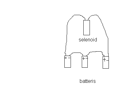

The solenoid on my rainbird sprinkler valve is just not actuating. I have three 9v cells connected in series as a power source. It says 24v AC and I have 27v DC, is this a problem?
How can fix this problem? I have roughly an hour starting now to fix this. :evil:

I don't see why this wouldn't work. I have run a sprinkler solenoid off of a 12v DC gel cell for my rocket base, no problems at all. Are you sure you have your 9v batteries wired correctly?

Make sure you have it all wired like this. And then give it a try.
