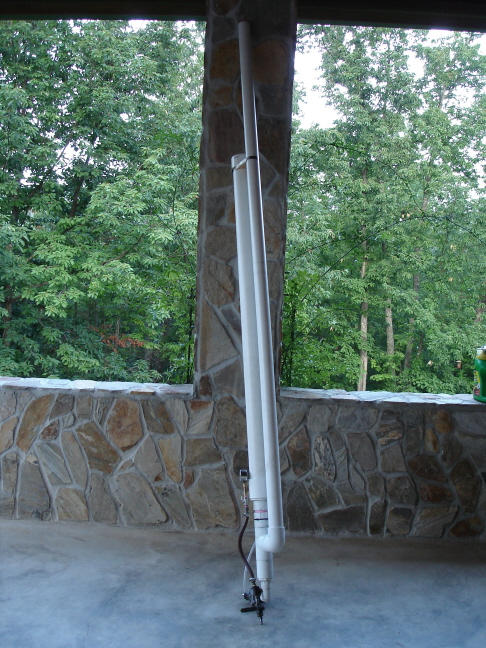

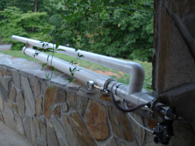

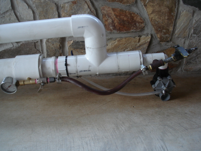

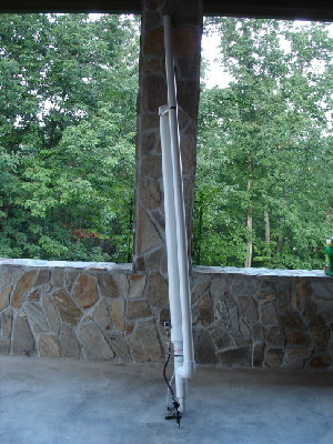

This is my first post and latest cannon
specs:
8ft x 2in sch 40 barrel
5ft x 3in sch 40 tank
full 2in port piston tee valve triggered by a modded rainbird sprinkler valve
Ill post a video soon breaking some cinder blocks with a potato
pic of the valve assembly

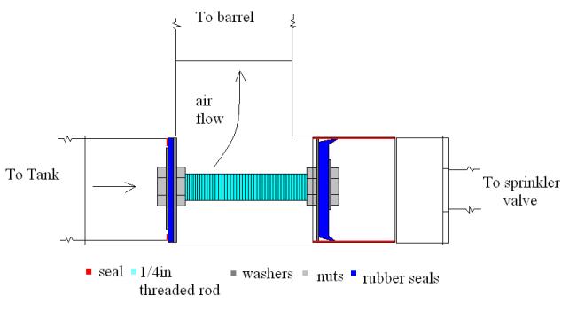

valve schematic
valve schematic

The real beauty of the design is the extended tee that lets the piston travel father back opening a full 2inches and man this thing is powerful even at 30psi its got some kick!

Anyway it roughly calculates how much 'travel' your piston needs to open to achieve full flow. You want to limit how far your piston can travel back to cut down on pilot volume (wasted air pretty much) but you don't want to cut down too much and limit your flow.
In barrel sealers we generally use D/2, which means barrel diameter divided by 2 gives us the maximum distance the piston should travel back.
Though in chamber sealers it's a different story depending on where abouts your pistons seals against the chamber in the tee. 1" travel is probably enough for the piston but I can't say for sure.

MrCrowley wrote:In barrel sealers we generally use D/2, which means barrel diameter divided by 2 gives us the maximum distance the piston should travel back.
Well with that kind of chamber seal it does need at least 2" of travel to fully expose the barrel port.
Using a fatter valve body and an unconventional design can give you a chamber sealer that has between d/4 and d/2 travel though.
That's why I said it depends on where abouts the piston seals, if the chamber extends all the way to the edge of the barrel port, then 1" might be enough as if it had 2" travel, all the air may have already been gone by the time it's fully open.
I'm not totally sure though, it would be interesting to know if anyone out there has some figures.

I missed this one yesterday. This thing looks like a real brute. Even though the pilot and meter hoses could be tightened up some, it has a nice technical look to it.

Not only are the D/4 nazis not afoot, they would be pwned anyway, because that looks like a chamber sealing valve!
We need more posters like you, cardman. First post is a finished chamber-sealing piston valve (if I am correct in assuming the valve is chamber-sealing). If it's not chamber sealing, I'd be interested in some pictures of the valve internals (I'd be interested anyways as well).

I know I already posted, but after you posted that diagram, I realized a few more things I liked:
1.) The simplicity of your design. It has been reduced to the purely critical, which I like. Not a lot of time has been spent fretting over how it looked. Also, equalization is uncomplicated and very effective between the pilot chamber and main chamber. Instead of working on some sort of one-way equalization flow through the piston, you slapped on a manually controlled external equalization system.
2.) You have really stepped away from the stereotypical chamber-sealer, like the Supah valve, in the simplicity of design and lack of aesthetic worries. Good job.
