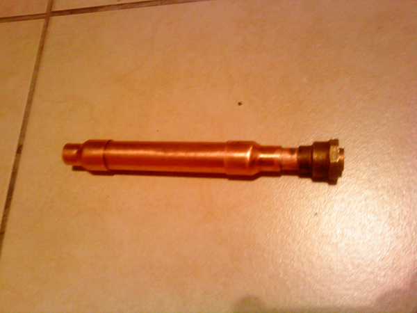

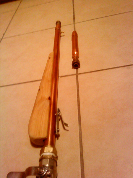

My new copper gun with piston and a nice aluminum sight and detachable silencer with steel wool sepressor.
Ask away
Work at round about 200psi now (New pics of gun on page 2)

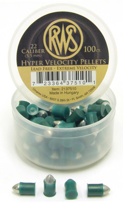

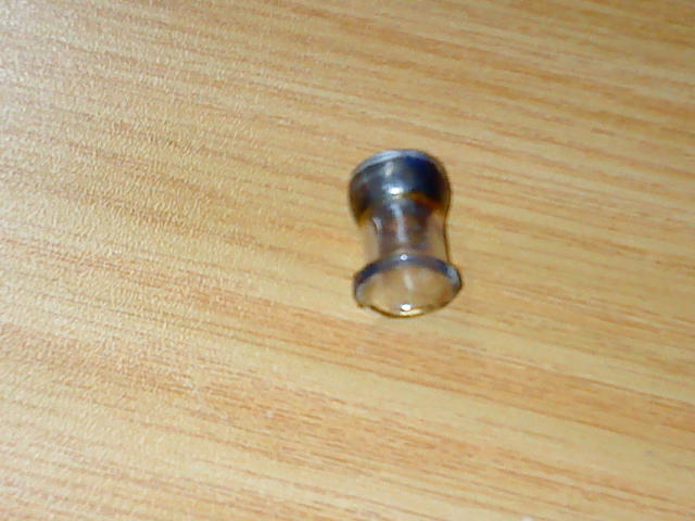

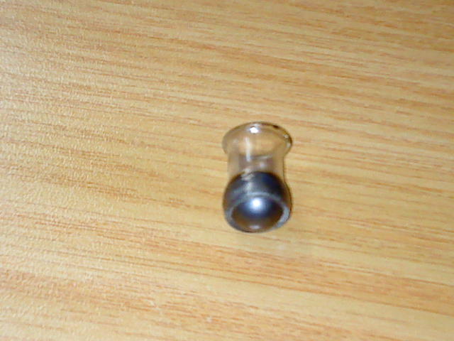

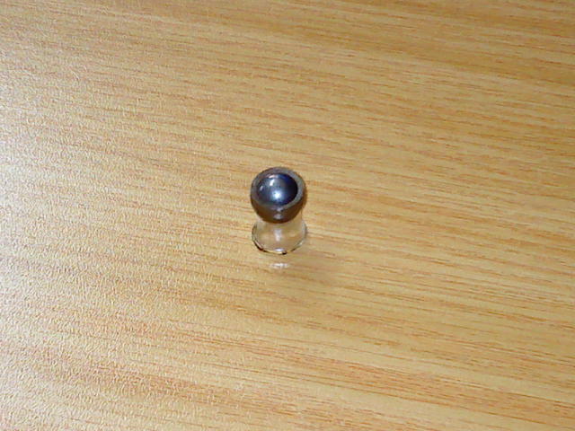

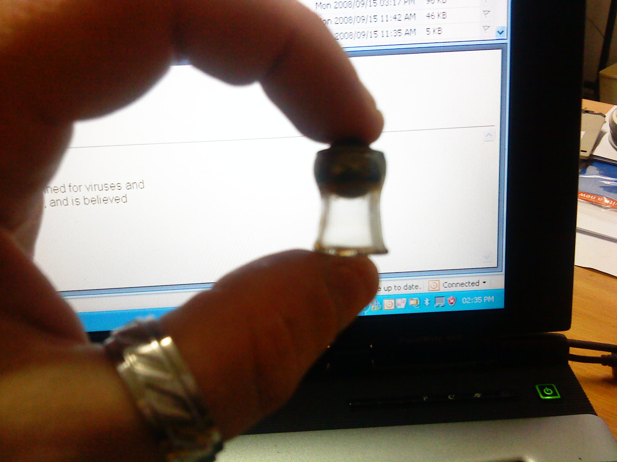

Edit: the new bullets is a 13mm steel boll with a 10mm fish tank hose over it and the rear has been heated up and bended outwards to create an air seal that will seal if air hits it, like a air gun pellet, the lead free ones like these.
o ps and a little Q-bond in the inside to make the steel ball stick.

Silencer
Silencer

My bullets is based on this air gun pellet
My new Bullets
My new Bullets
My new Bullets
My new Bullets
My new Bullets
My new Bullets
Side view to c the form better

wow I am impressed.... that sight looks really nice
does the silencer work good at reducing sound ? I suppose it does because you gun already has features that make it quiet
sniper hero
Posts: 332
Joined: Fri Mar 07, 2008 3:12 pm
Tue Aug 26, 2008 6:00 am
very nice gun I like the wood and the sight
good work

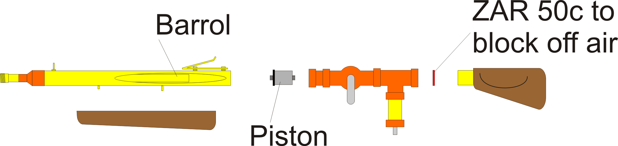

but a piston ? how did you do that?

It works like this:
And the silencer works ok, it takes away that Crack sound but you will still here the gun loud if you take the volume of the silencer up to say a 2 or 3 times the barrel volume it should work very good but then your gun looks weird.

ok now I understand :P

You can shape and bend the BV handle to b more trigger like, and if you take a bike handle-grip ( watchamacallit) they fit 22mm pipe nicely.
Some handles are already shaped with the fingerinprints and all.
that would look great.
( that would require you to take off the compression ring)
