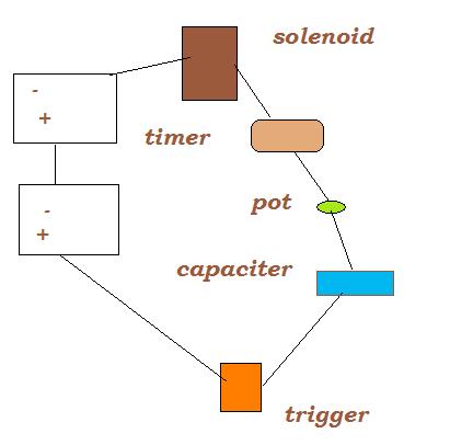

I've got my radio shack cart all set up so could you please explain the circuit to me in english? I guess my question is how do i control the rate of fire? would the circuit look like this?

i have a circuit from a book of mine that has an "astable" occilator that is EXACTLY what you want..... minus the MOFSET to control the solenoid off of the input. ill post it when my parents get off the computer with the scanner on it.......

BTW, i really dont get your diagram. If your getting a breadboard (the thing with abunch of holes) post a link to it and ile tell you what to hook up wear, breadboards are labled with grid corrdinets Eg 1xc is first column and 3 down.

nevermind.......... rp181 gave you all the info you need to make a circuit 100X better than the one i was going to give you...... that and our scanners broken......
