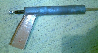

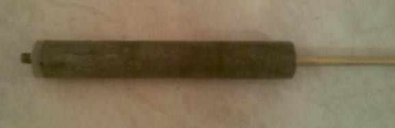

Nothing special and not much to look at really, a metre long 6mm brass barrel, section of steel water pipe as a chamber, schrader fill/pilot valve and as always, plenty of epoxy :) something like this but with the seal on the piston as opposed to the barrel.
I hope to add a decent trigger to this one though, now that my rifles are elsewhere I need something powerful I can actually aim :D

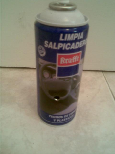

No videos for now, I did have one of the dashboard cleaner (dashboard cleaner?!?! wtf! it deserved to be shot!) getting high but the blast from the half full aerosol knocked my cellphone over hehe. I'll make some decent ones in time.

entry hole
entry hole

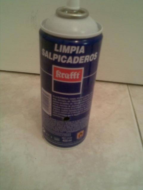

exit hole
exit hole

Pretty darn decent penetration!
Great entry hole!

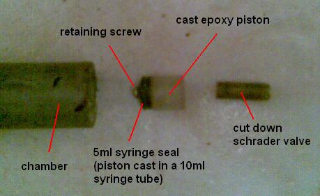

... a a a a nd in true JSR style, it's stopped working. Last time I fired it there was a "pop" noise while I was filling, I'm guessing the seal has somehow been dislodged, and now the piston won't seal. Out comes the hacksaw again :roll:

Hacked/chiselled off the back end and took a look at the piston, as I suspected the rubber syringe seal had torn off and left the barrel after I fired. I added a new seal, this time secured with a screw and held down with araldite, hopefully that will do the job. Videos to follow if it's more durable now ;)
internal details
internal details

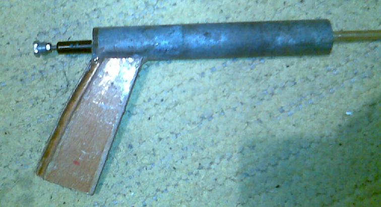

Another small update, added a grip made from a conveniently shaped piece of discarded chair, and a simple thumb trigger to make it more comfortable to fire. I was planning something a little more elaborate and conventionally operated but it's frustrating without my workshop so I went for ghetto, simple but functional :)

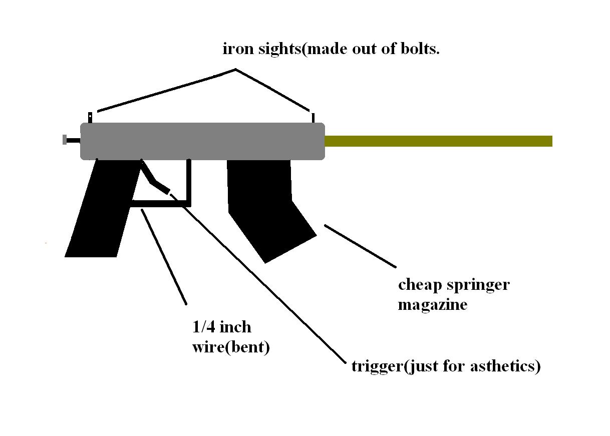

Nice, but Might I suggest something like this to make it look mor realistic, you could make it for about 5-10 bucks, and will make it look 100000% better.
Fri Sep 19, 2008 5:52 pm
Not too worried about aesthetics to be honest, this project will be discarded by the end of the year anyway - I just want something I can use. In that regard, iron sights of some description will definitely be fitted, as well as a barrel shroud to stiffen things up and act as an integral suppressor :)
