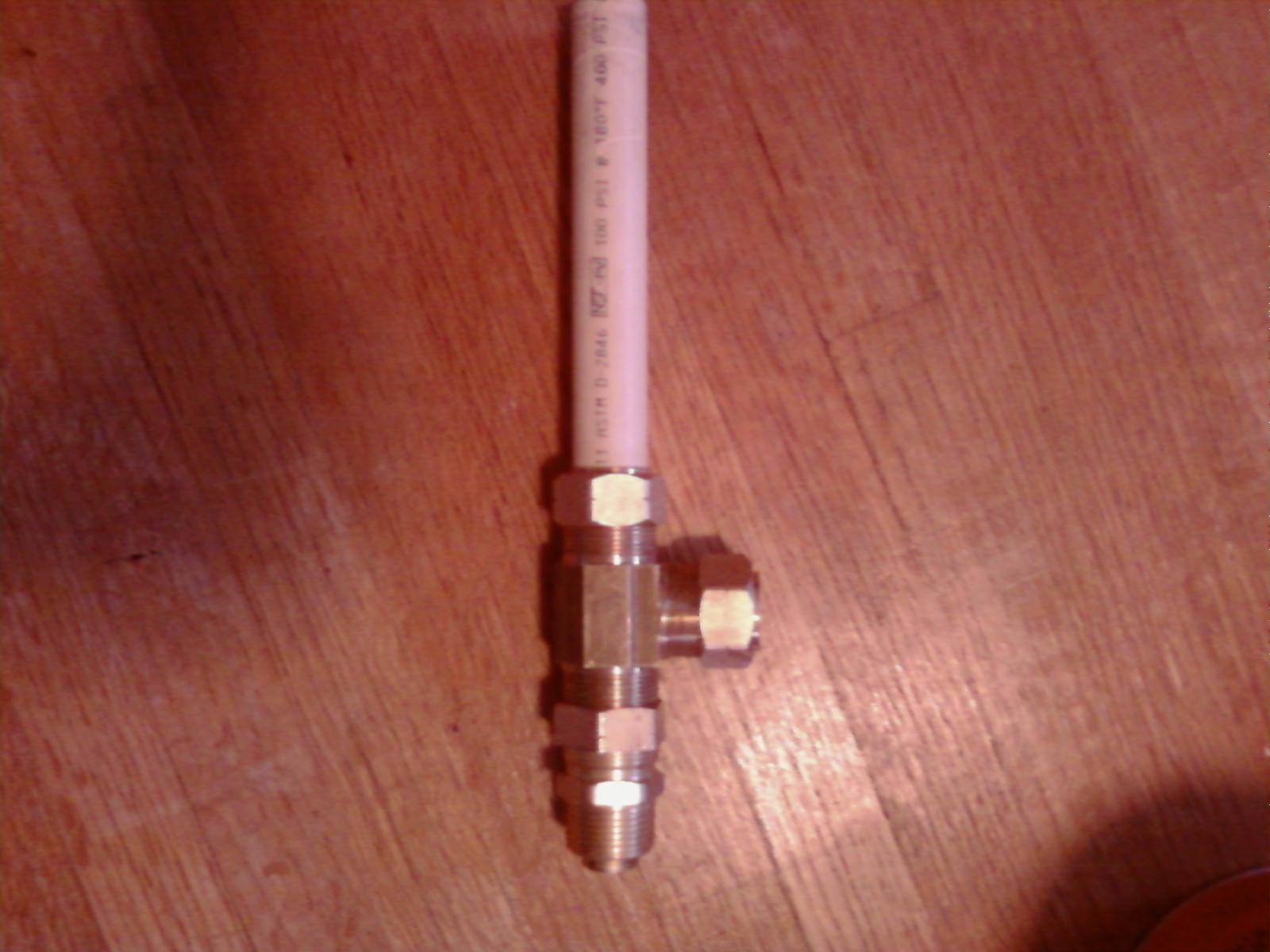

As far as the semi-auto mechanism goes: it uses a 7/8" compression tee connected to a 3/4" MPT to the QEV. as far as i can tell, all i need is the proper spring to move the bolt back, the one i have is too strong, keeping the air from pushing it forward and closing off the hopper.

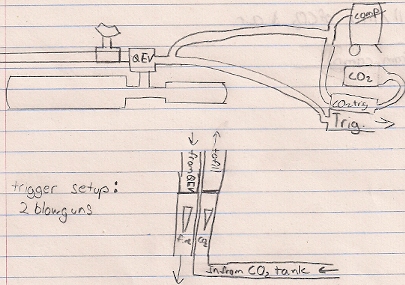

Also, i want to be able to have two blowguns, one the QEV trigger, and the other to remotely control how much C02 is added. Has anyone ever seen a blowgun out there SAFELY handle more than 150PSI?, if so where did you get it?

ok here is the outwardly finished semi auto mech
inside, riding on the compression inserts is a peice of 1/2" copper, a spring pushes the assembly back to allow a paintball to fit, hopefully, the air will cause it to "blowforward", locking off the hopper

as for blowguns, pressure washer spray handles are rated to something on the order of 1500psi.
most spool valve paint guns run at between 120psi and 200psi.
by using a larger dump chamber there's no reason that you could not run a paint gun off LPA.

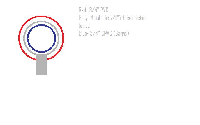

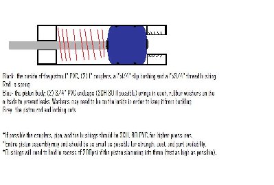

The aforementioned semi auto piston will connect to the tank , and ride under the barrel so there is a place for the hopper, here are the two diagrams. I know LPA must mean air- Low Pressure Air? Is there any ideal pnuematic chamber to barrel ratio as in combustions, or even a mathematical formula?, i dont really have the money to test such a thing.
Is there any high-pressure valve that can come near a QEV's performance, besides the hommade pistons(i dont trust modded PVC), and a butterfly valve? Especially ones that can be air actuated like a QEV?

as for the valve, an unbalanced spool valve (blow-forward bolt) would be simple enough to create, the only reason I haven't is I've got three other projects I'm working on already.
here's a an animation:
as I said, shouldn't take to much effort, doesn't even need to be 100% sealed if it's just the bolt and not the valve.
I'm still not sold on the dump-chamber controlled bolt-ram method or "semi auto piston" as you call it.
Correct, LPA stands for Low Pressure Air.
you can make a piston/diaphragm valve using copper tube or even gas pipe.
and as for C/B ratios, Google GGDT, or Gas Gun Design Tool.
