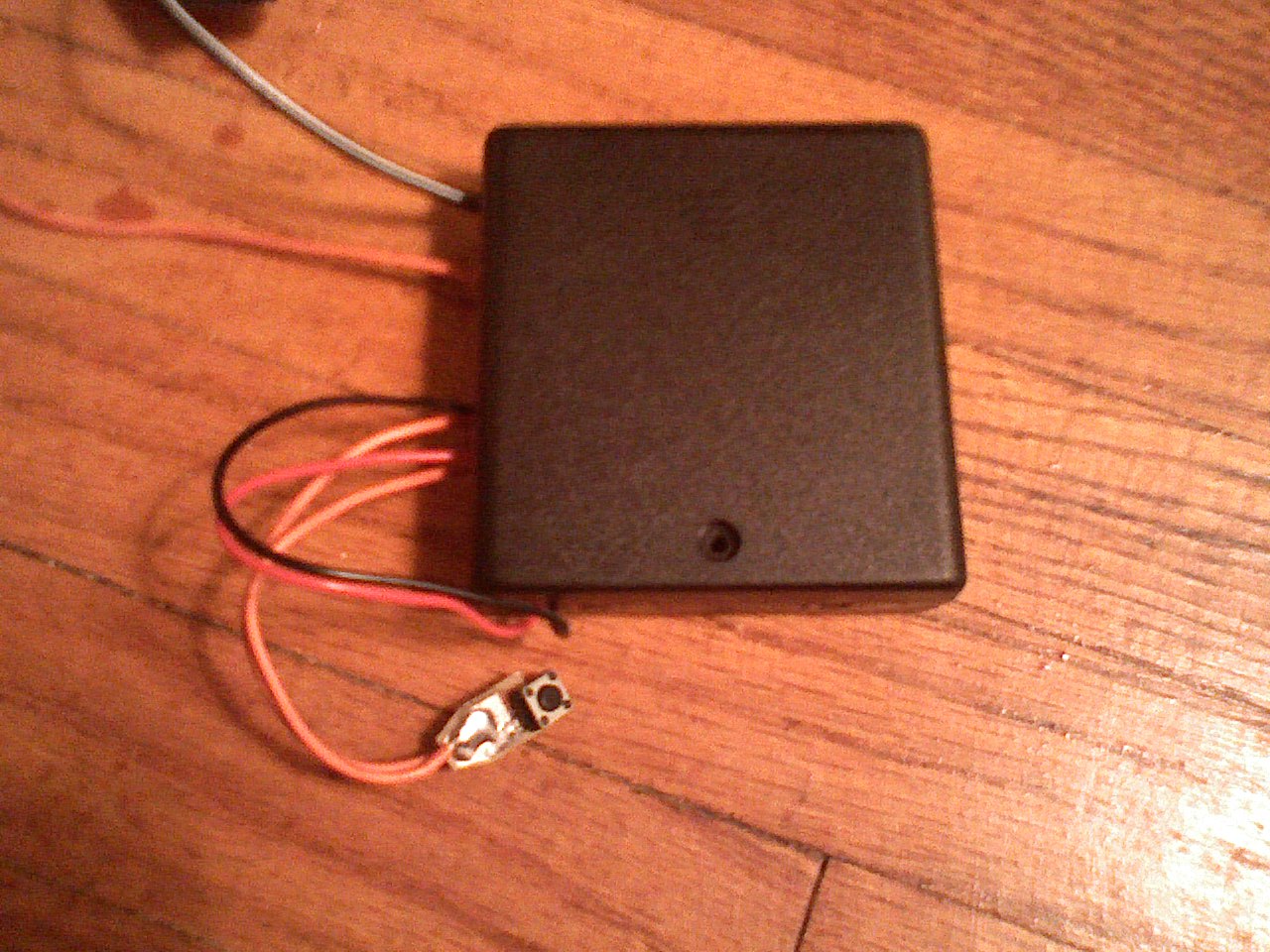

Just thought I'd keep people posted on my progress. Last time I posted, I still needed a power source and trigger mechanism. Seems like the common thing to use are 3-9v batteries and some sort of push button switch to activate the solenoid.
After working on an unrelated project, I came up with something that works pretty well. I took apart an old camera and discovered that the flash circuitry could be adapted to power my solenoid and the cool part is that it only runs off of 2 AA batteries.
Here's the concept:
Normally when you fire up a flash on a camera, a transformer charges up a Capacitor which stores necessary voltage(this one was 330V) to power the flash. Obviously, 330v is a bit much for the solenoid. So I removed the original capacitor and replaced it with a 35v one and now I have my power source. I added two micro switches to activate the power source. One is to fire up the transformer to charge the capacitor(that's the high pitch whine you hear on a camera when you push the flash button and the other is for the trigger. This sort of works as a safety because the gun won't fire unless you hit the charge button first. It only takes a few seconds for the capacitor to charge then you're ready to fire..
Another feature of this system is that the capacitor discharges in a very quick burst. What this means is that instead of keeping the solenoid open and expelling all my air, it opens and closes real quick so that I can actually get 2 shots out of my air chamber. If I fill the chamber to 80 psi, I can usually get another shot at about 50 psi before having to refill the air. Cool!!
Here's what the power source looks like.  Silver cylinder is the Capacitor, transformer is the black square in the middle, and the 2 AA batteries.
And every thing fits in a standard 4 AA battery holder.  This is with the cover on.  You can also see one of the micro push buttons in the picture
A rough mock up of it attached to the handle
