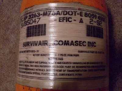

2. What does the writing (pictured below) mean, and is it relevant to me?

the numbers on the label that you should pay attention to are the DOT-E 8059 this tells you how often it must hydro tested . if that is 4500 after the DOT number that means it is a 4500 psi tank. the 2-92 is the born on date , that is when it was manufactured and first hydro tested.
