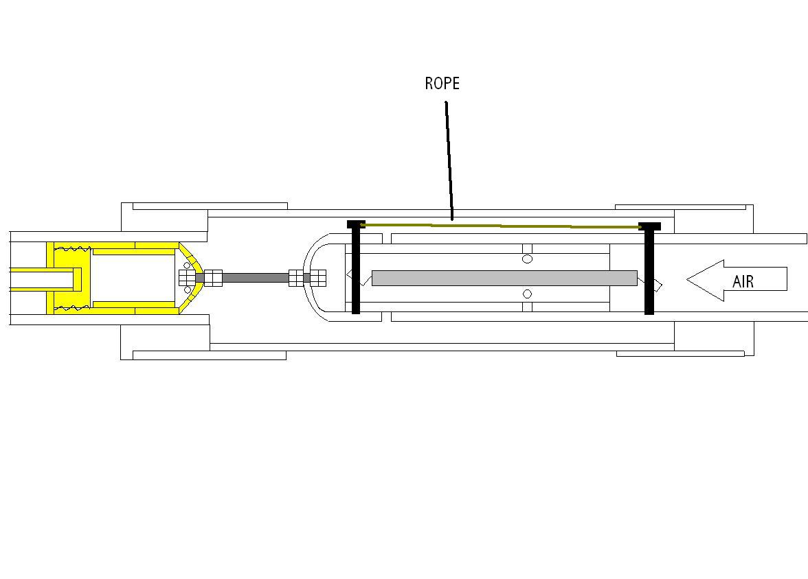

I want to tell the details, i am making the diagrams now, i been buzy because i was working on my prototype.

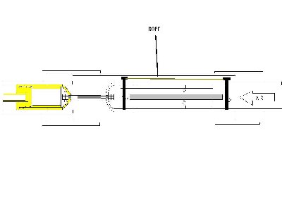

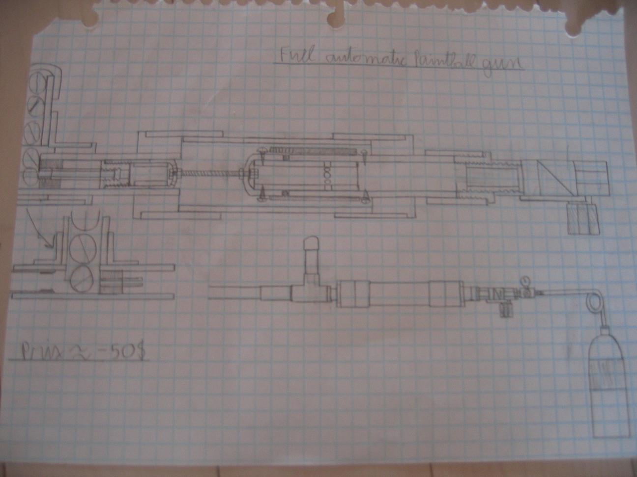

Okay, maybe this thing already got posted, but if yes, why dont evry spudfiles member dont have a gun like this? its able of full auto and semi automatic, you can even set it for 3 rounds burst.
The gun is actuated by an 3/4 inch electricaly activated sprinkler, so , with a 555 timer, you can set the firing timing you want, very simple.
The paintball loading mech is not on paint, but i am shure you can understand .
The cool thing in that is that you dont need any special modded pipes or pieces, the piston is 1 inch, its casing 1 1/4 and the whole casing 2 inch.
The paintball barrel(not in diagram) is a 3/4 inch cpvc pipe, wich fits paintball PERFECTLY.
It can work with a air compressor or co2 bottles, but i will have to find the the regulator and all that, wich i think will be the hardest for me.

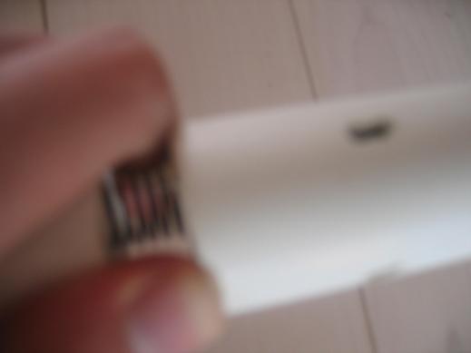

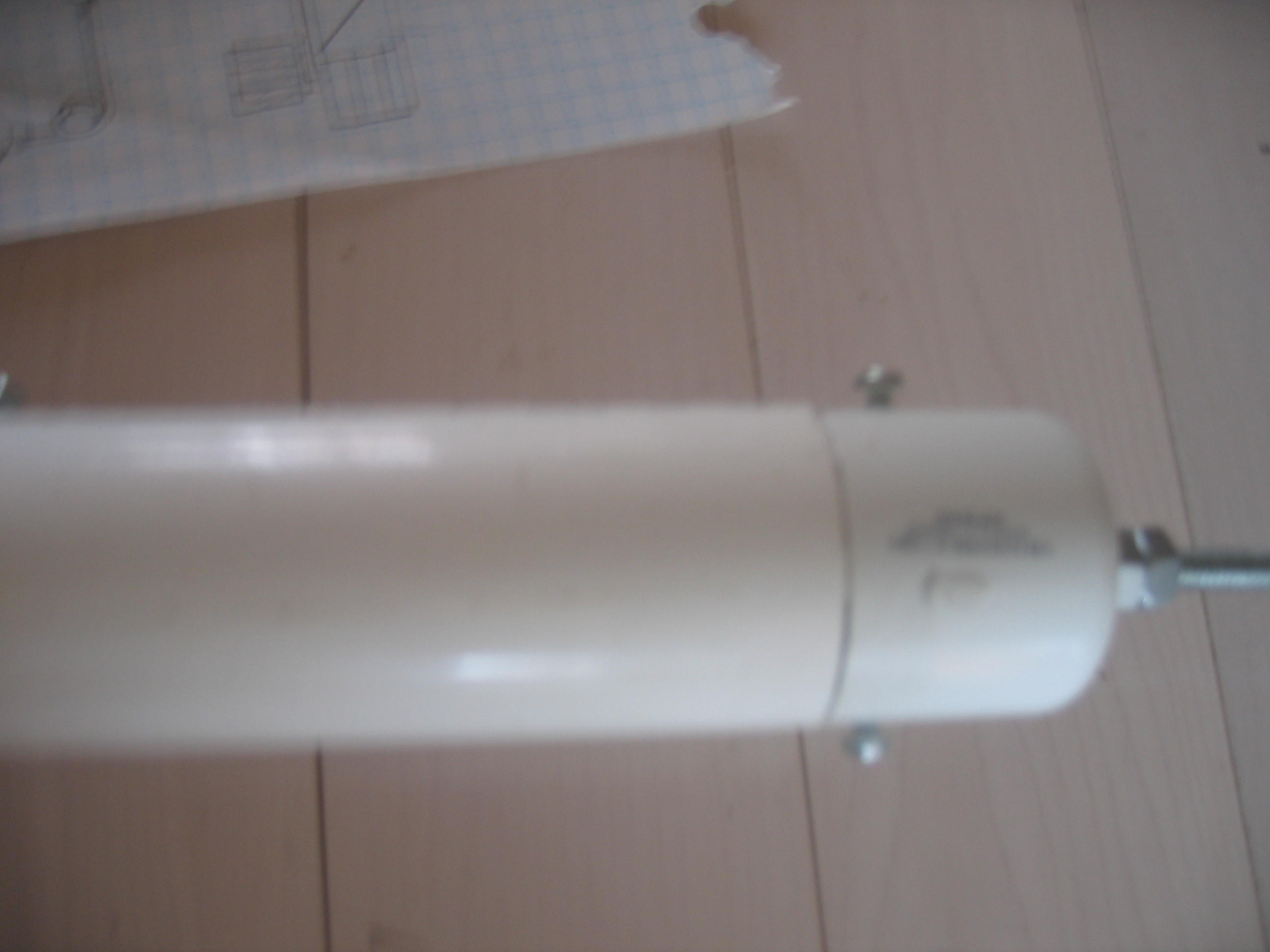

- the air escape holes
- IMG_6813.JPG (14.47 KiB) Viewed 4501 times

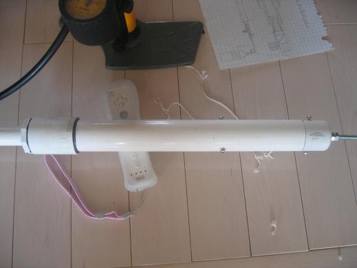

- prototype and the spring
- IMG_6812.JPG (12.94 KiB) Viewed 4501 times

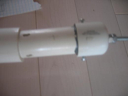

- prototype
- IMG_6811.JPG (21.68 KiB) Viewed 4501 times

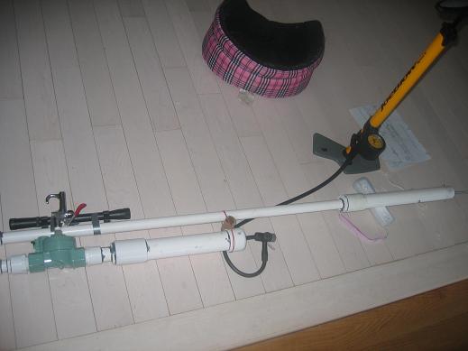

- THE PROTOTYPE ON ITS AIR POWER SOURCE( MY SNIPER :)
- IMG_6810.JPG (25.24 KiB) Viewed 4501 times

...Isn't that just a bfb?
xnt rnm ne z ahtbg
xnt rnm ne z ahtbg
- inonickname
- First Sergeant 4
- Posts: 2606
Search before you lay claim on something.
I've seen a sprinkler valve used (in a spud gun specifically) to be actuated with a timer circuit based on a 555- i.e. it's been done before. The blow forward bolt is also in use...E.g JSR's designs and Clide's semi.
Both been done, but I don't think they've been combined if you want to be technical.
