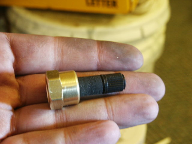

In a pinch you can make one with a tire valve and 1/4 inch pipe cap.

Threaded schrader valves are not going to be found near the pop in schrader valves. They are used in air compressors, so that is the section they can be found.

uhhhhhhhhhhhhhhhh, I have found these threaded schrader valves at both koi (its local) and NAPA auto parts stores. However, I guess you can probobly get one in the compressor section too, it depends where you're looking

just go to ace hardware, the sell threaded schrader valves, all you do is drill a 1/2 inch hole, or 1/4 inch depending on which size you got, and screw the valve in there, works perfectly with no leaks at all, i suggest though putting it where the endcap is joined to the chamber, that way there is more pvc for it to hold on to because its twice as thick
