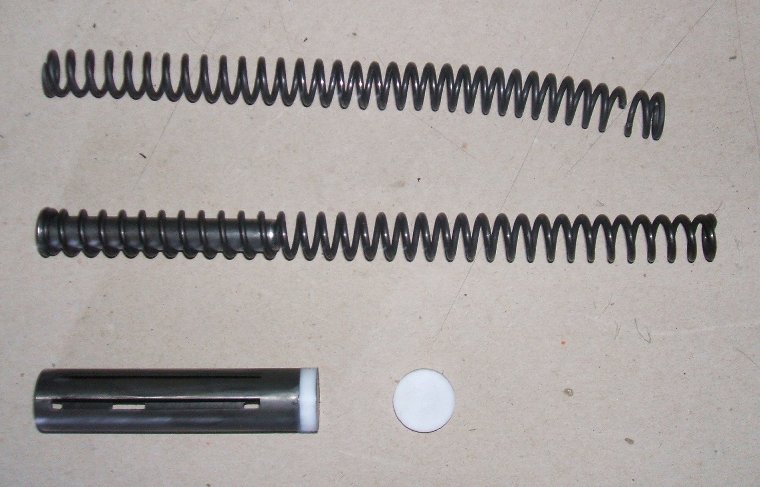

maverik94 wrote:I dont see why it will be so weak. If I have a 1 1/4" chamber, 1' long, and a 5/16" barrel, the reduction in the volume will be so huge it would generate quite a bit of power. At least that's the way I see it.
I have one of these, recently I had to change the spring and it was quite a chore. As you can see from the attached pics it's a massive affair and with lots of preload, if fact there's no way you could preload it manually by pulling, let alone cock it - this is why most springers use some sort of lever mechanism.
Even with all this stored energy, it only manages 4.5 ft/lbs of muzzle energy. This is equivalent to chucking a 100 gram slug of potato at a mere 35 feet per second, something which even the most basic combustion will achieve with no effort whatsoever.
You can imagine therefore what sort of power you'll get for something which can be cocked manually. Well, of course you can. Airsoft pistols ;)

The people here are correct; power will be rubbish. Even to push 100 psi the spring will have to put in the same amount of power you would (100 lbs/in^2). This is a very powerful spring, and will require a lever or reduction method such as a thread to recock.
Then add to that you need a trigger mechanism and strong seals with minimal friction, power will be junk.
If you decide to even try, a compressed gas piston is the only way I can see this working.

My 0.6J airsoft shotgun can just about have it's mainspring cocked by the rather infeasible "one-handed pump" method (you know the kind of thing), but it had to have extra weight added to the body and it still takes practise and sheer violence to do it.
Looks damn cool though.
There'd be no chance of doing it with my air rifle though - aside from the fact that it doesn't have a pump. In fact, on that note, you never see any springer more powerful than a airsoft gun being cocked with a pump action - which should give you an idea of the spring forces that are needed for relatively small muzzle energies.
Although disassembling my Air Arms is no great chore to manage, the TX is renowned for being very easy to maintain, and for being able to be disassembled or reassembled without any form of spring compressor. But even then, I still need to put the muzzle of the rifle down on some carpet and put a lot of weight on the trigger block when taking it apart/putting it together.
Without putting my weight on it, the task would be pretty unattainable - taking an end of the mainspring between each palm, it'd be an exceptional person who could compress the two ends much more than half an inch together.
The forces on it when it's actually compressed and cocked in the rifle - like I said, if it came loose when my hand was in the way, I would find myself without a large amount of finger, and I'd have to start to learn to write left handed.

Very very powerful mainsprings - and often, quite a bit of overgenerous marketing. It's rare to actually see an air rifle make the velocity it's marketed as capable of.
My air rifle is only good for about 800 fps, but even then the rifle has to be built like a tank to contain the spring. To give you a comparison, it weighs more than most fully loaded assault rifles.
Seriously. An M16 with a full 30 round magazine weighs about 4 kilos. My TX 200 weighs in at around 4.7 kilos - well, technically, it's 4.2 kg without the scope, but it's got no built in sights, so it can't be used without a scope, so for functional purposes, in working order, it weighs 4.7 kg.
It also needs a big mechanical advantage to make it possible to cock it. That's at 800 fps. 1200 fps rifles need to be built tougher and with stronger springs.
You should also consider the energy in a 1200 fps 8 grain .177 pellet is only 25.6 ft-lbs, not a very large amount (although it could still kill a person if they were rather unlucky).
