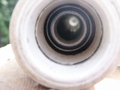

Mouse Musket valve seat.  Piston OD 1.5 inch. Seat 1.25 inch. Barrel 1 inch.
