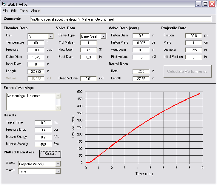

when setting it as barrel sealing what would i put the piston diametre as ? figured its about .276inch ish ? even when i change it around the gun still has no power at all. cant figure this out for the life of me :(
i have searched ggdt to try and learn how it works im not being lazy ... just the only idiot who cant figure this program out sorry.

Try make your projectile a lot lighter, and see what you get.
Sat Aug 01, 2009 11:10 am
jordzan wrote:when setting it as barrel sealing what would i put the piston diametre as ? figured its about .276inch ish ? even when i change it around the gun still has no power at all. cant figure this out for the life of me :(
Image[/img]
Garbage in garbage out. I was looking at your acceleration graph and realized your acceleration is mostly very late in the curve.. Then I looked at the piston mass.... :D
Wow.. Solid lead piston.
No wonder it is slow.. Then I looked at the dead volume. 3.05 cubic inches. May want to revisit your dimensions as start over. Start with the weight of the piston and follow it with the volume of air between the piston and projectile.
To find volume.. Take the cross section of the cylinder and multiply by length. To find the cross section, use Pi times the radius squared.
Your bore is 0.256 inches. Radius is 1/2 the diameter or 0.128. 0.128 times 0.128 is 0.016384. That times Pi.. 3.1416 is 0.051471974 square inches of area. For a volume of 3.05 cubic inches the barrel has about 60 inches between the valve and projectile. :D You might want to try again with the projectile a little closer to the valve. Then you may want to find a closer value for the mass of the piston.
Find some real values instead of garbage values to put in in order to get something besides garbage out.

the most i can get out of it is 167 ft/s .... with lighter projectile and trying different combinations of barrel length, chamber sizes and psi rating.
is 3/8 qev to 1/4 barrel just never going to shoot well ? not sure if should just scrap this gun and sell the qev etc or ignore the program and just build the gun ?

Tech, he's obviously using a neutron-star derived projectile also, you'll find that 100g is a bit high of an estimation for a 1/4" projectiles.

put the piston mass as .5 ounces put the valve seat as .1875 and the projectile as 2 grams and you will get a better result and the dead volume should be under 1" cubed also i got 309fps with your cannons specs
EDIT:oh nvm seems ino got to it before me but the valve seat is .1875 or 3/8"s. woops i'm wrong about that. i just divided 3 by 8 and used that maybe i should check before i post lol

spudtyrrant wrote:put the piston mass as .5 ounces
Pistons in QEV's are extremely light and small- basically a perfectly shaped piece of rubber. .1 ounce at the most.
Also, the porting isn't exactly 3/8"- that's the imperial thread size. I'd put my money on the porting being basically at least 1/4" or higher, so I wouldn't be concerned too much.

excellent thank you so much, seing all the mistakes clear as day now.
I've taken the qev apart and measured and weighed all the parts i think i need too.
Just to make sure, have i got the correct idea about the seat and vent diameters in the picture below ?? as too which is which ??

Piston mass - 0.1410958oz
according to the pic i just posted, vent = 0.408 seat = 0.591
Sat Aug 01, 2009 12:34 pm
in your pic 'seat' is, in fact 'vent' and 'vent' is 'seat'... however, in this particular situation 'vent' is so large that you should put there opening on your pilot valve (a rough guesstimate 3mm for a blow gun)
your seat (marked as vent in your pic :) ) seems quite large... have you measured its ID or OD ?? (you should measure its ID - if you did that that's ok and sorry)
