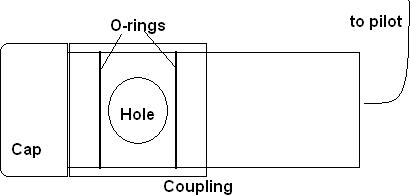

Hubb
Posts: 2390
Location: South Georgia
Tue Aug 04, 2009 3:57 pm
First off, you ain't gonna get 150 - 200 psi from a standard sprinkler valve. The pressure will be 120 max.
Next, to fire a 1" sprinkler valve, a 1/2" anything will do. A 1/4" anything will do.
As far as sleeve valves go, those things are pretty easy to make. Technically, this breech loader is a sleeve valve. Duplicate that to make it work for you.

Hubb
Posts: 2390
Tue Aug 04, 2009 4:14 pm
Hang on and I'll draw up a quick diagram. I'll edit this post when done.
