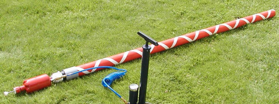

Long tennis ball barrel.  Only works at high pressure.  Low pressure provides too little volume.
Short tennis ball barrel.
