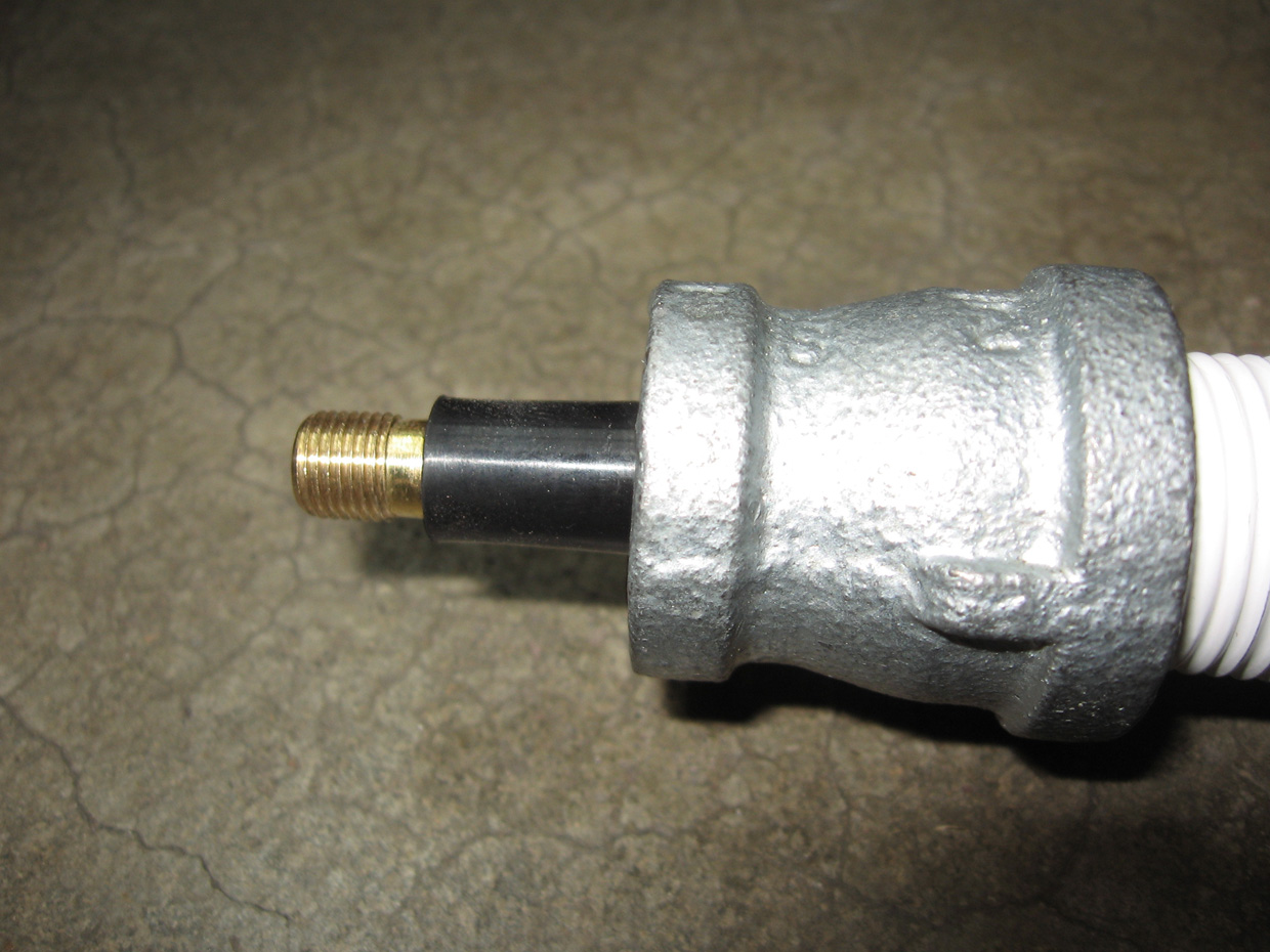

If you use a tire valve the way it was intended, they hold pressure very well.  Get a pipe cap and drill it for the stem with a hole the same size as a rim it is normally installed in.
Here is one I put in a 1/4 inch brass pipe cap. To get it to fit, I had to trim the rubber to a smaller size, but I've not had any trouble. I use this one to 110 PSI with no issues.
