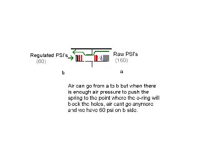

So here is my regulator, red is o-ring.
(Is there something that woul'nd make it work?)
The spring force will have to be tweaked with an air pressure indicator

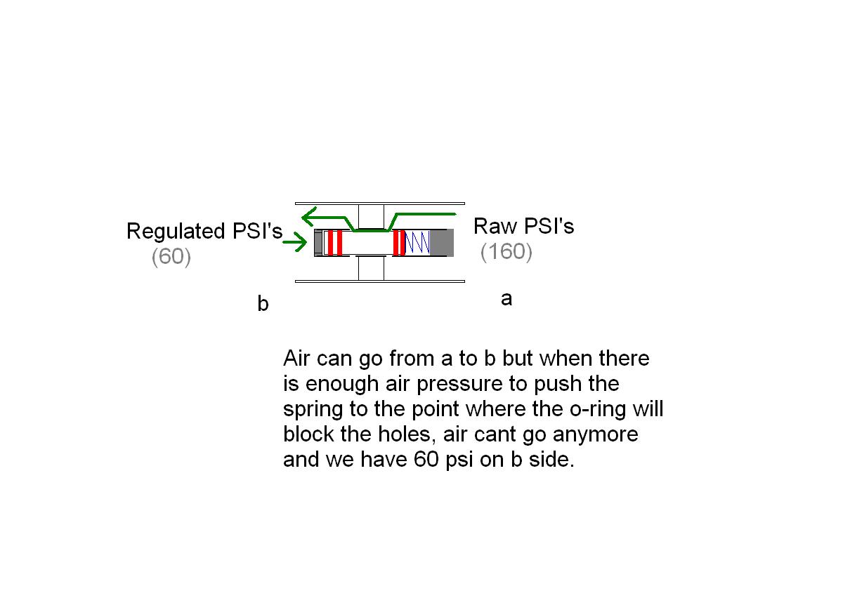

Its very simple, when there is 60 psi on the regulated side, the "pushbutton " counters the spring force, closes and no more air can go , so we have 60 psi.I don't fully understand how it works either, can you explain a little more?

I don't quite understand your drawing but, I think the spring needs to be on the low pressure side.
The theory is very simple: when there is 60 psi on regulated side, the valve shuts closed.
so that the valve closes when there is 60 psi on regulated side, the piston as to counter a spring to block the air that goes by the holes (green line)
When the piston is pushed towards the A side enough to block the holes with the o-ring, the valves shut and no more air can go to b side, so there is 60 psi.

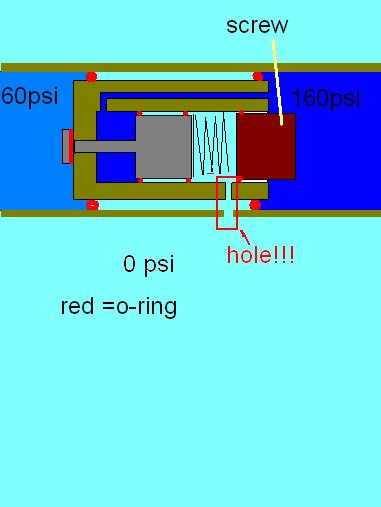

hi demon
you design is not to bad but you need a venthole between the spring site of piston and outside of chamber.
the outsidepressure is the referencepressure.
hope you understand me here a quick pic (note it is not scale, show not on the squares)
note the 0psi area in the pic
by
by

Thanks a lot Jean,
But i dont think that a vent hole is nescessary, as in auridruize, there is one, but it does'nt vents with ambient air, its stays in the airchamber.How can that be possible?
I tried to contact him without success, does anyone has his email address?
How can the screw get to seal ? or else air will leak outside of the air tank.
