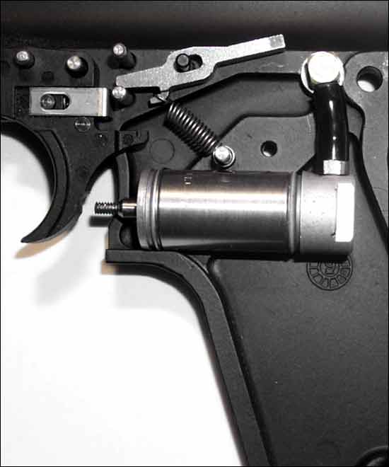

Check this pic out. I'm sure you've seen a configuration like this before. I don't know how much time and "playing with" you want to put into this, but here might be a solution to your trigger/sear problem. In the Tippmann 98 Custom, when the bolt is pulled back, it pushes the sear onto a trigger platform (we'll just call it that for now). When the trigger is pulled, the platform is pushed up pushing the sear down and releasing the hammer. As I said, if you have the time/patience for this, it seems to be a descent solution, and you won't need as strong of a trigger spring.
Don't pay attention to the silver barrel thing.  That's a custom part for the gun.
