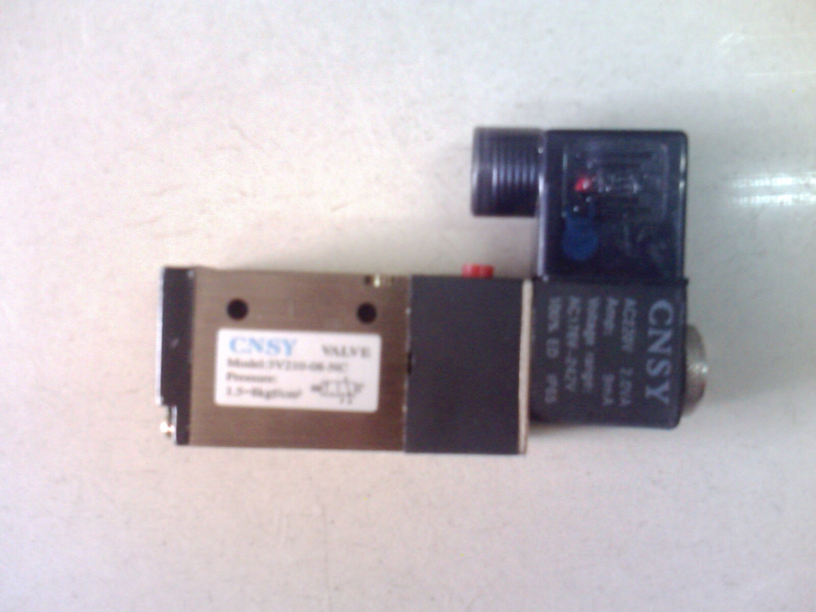

Solenoid 电磁阀

cangying wrote:Solenoid 电磁阀

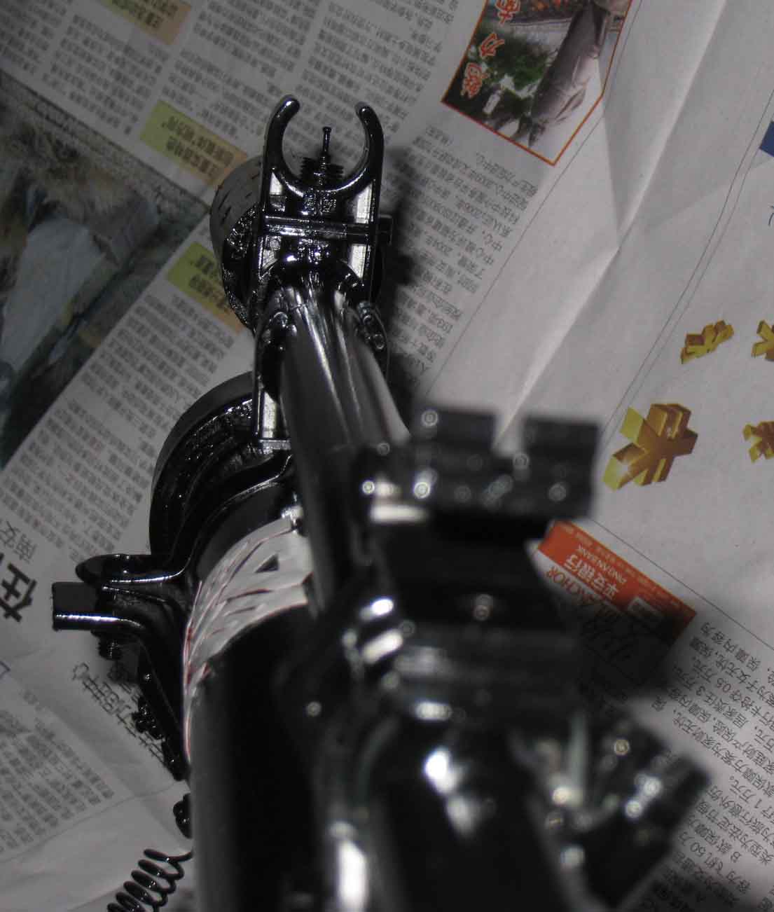

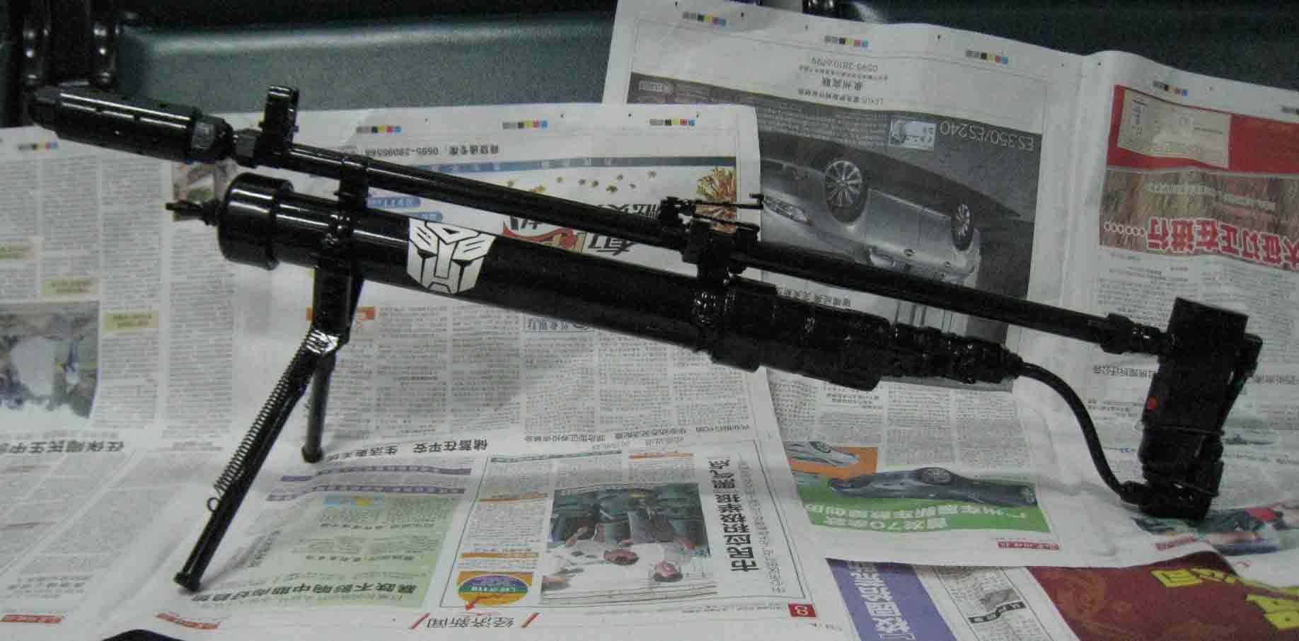

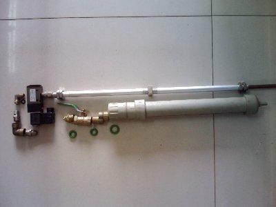

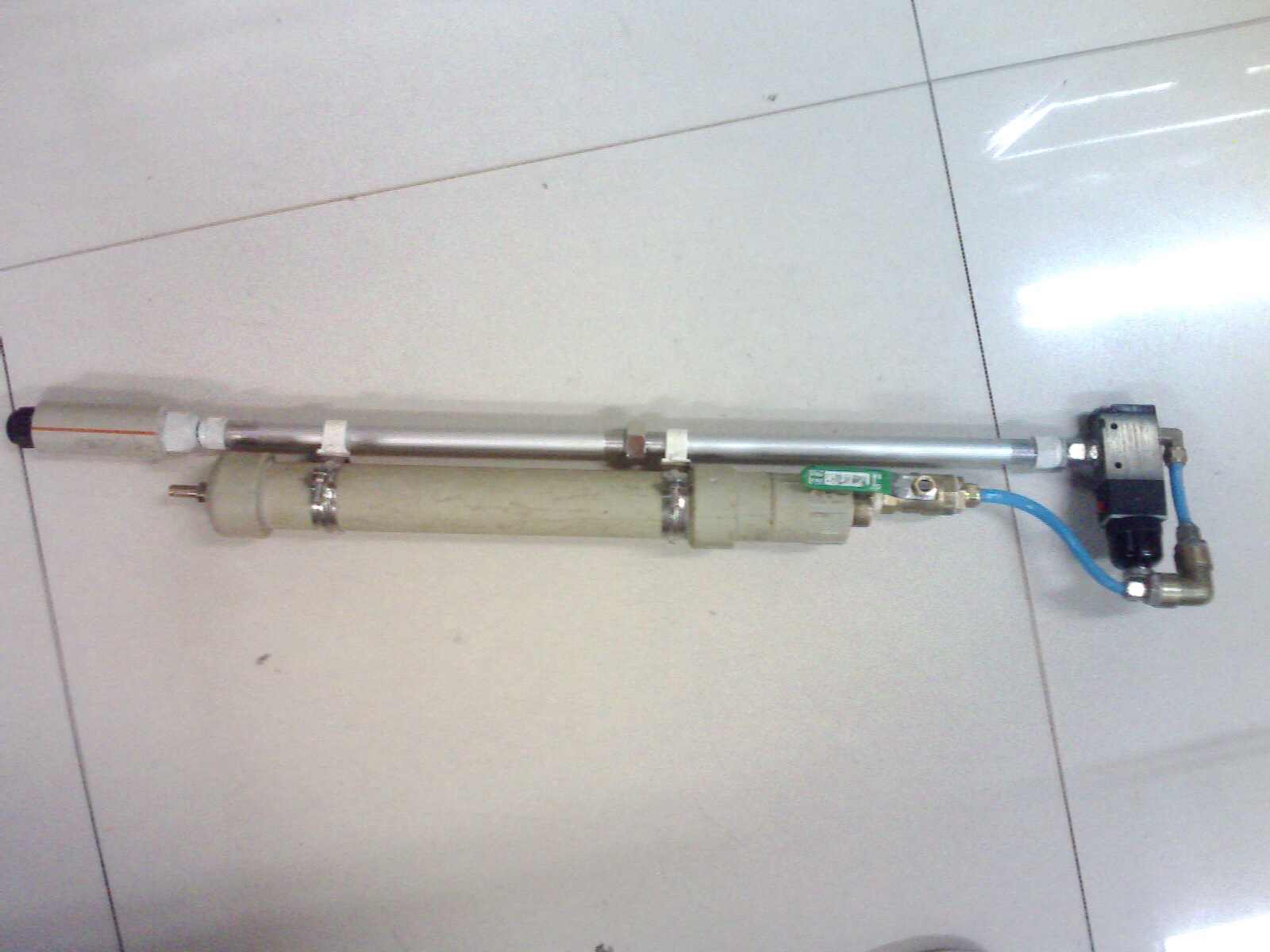

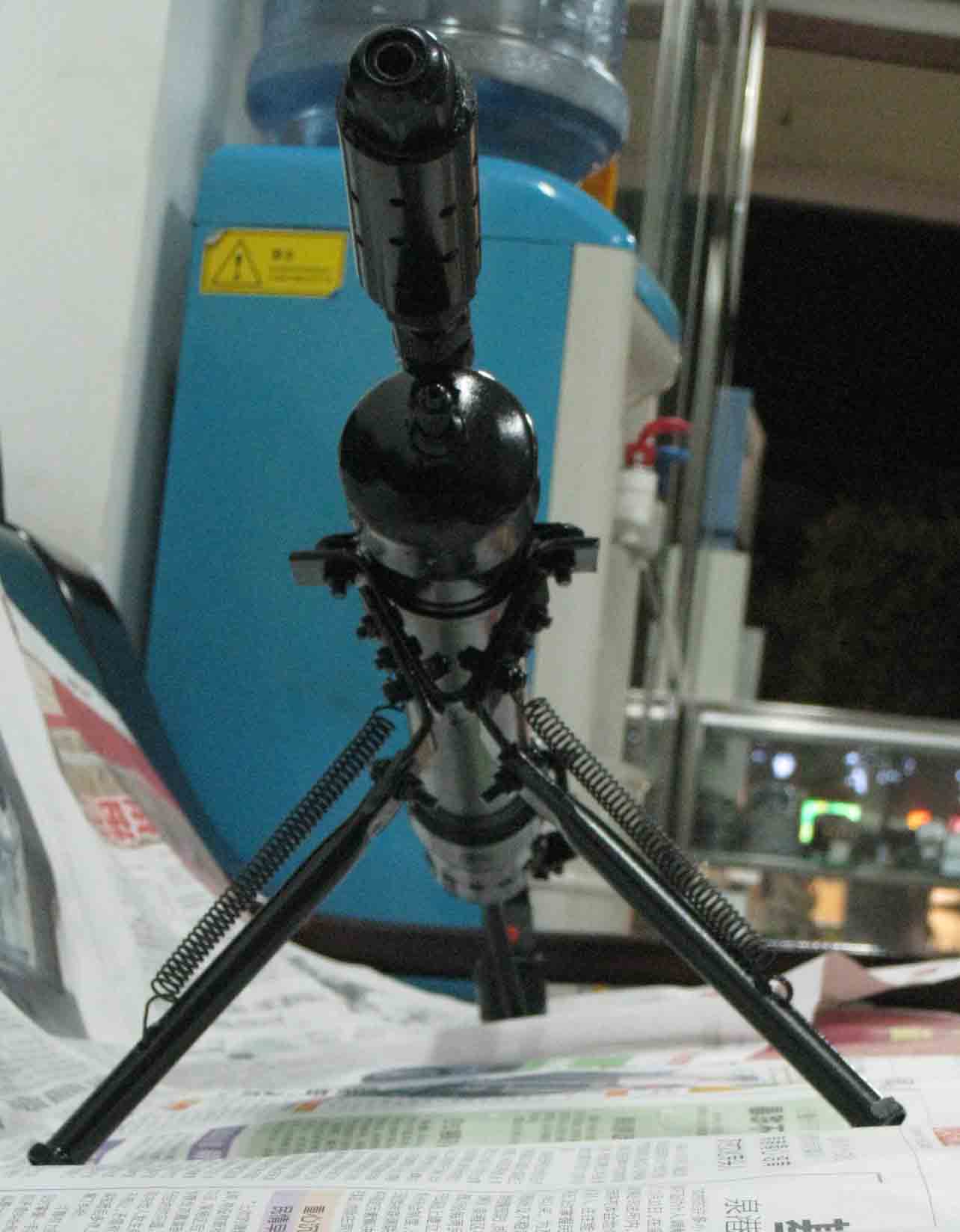

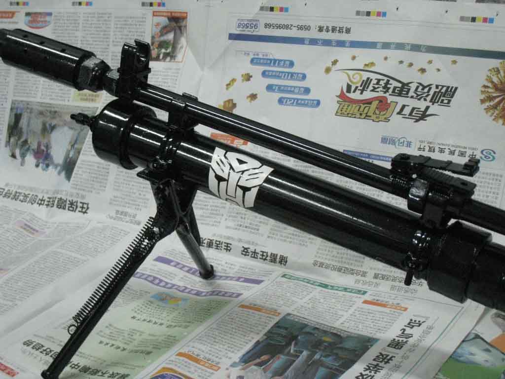

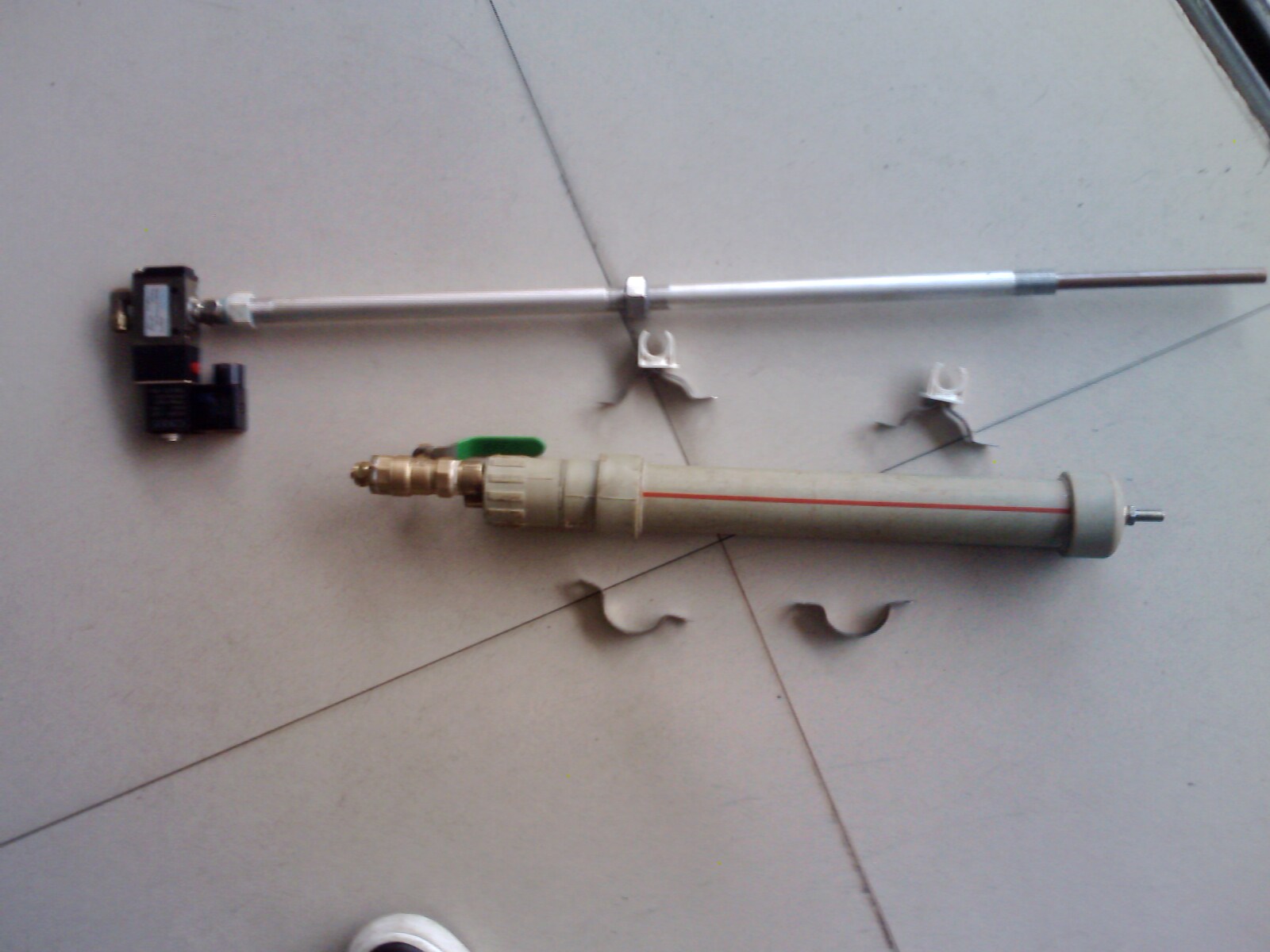

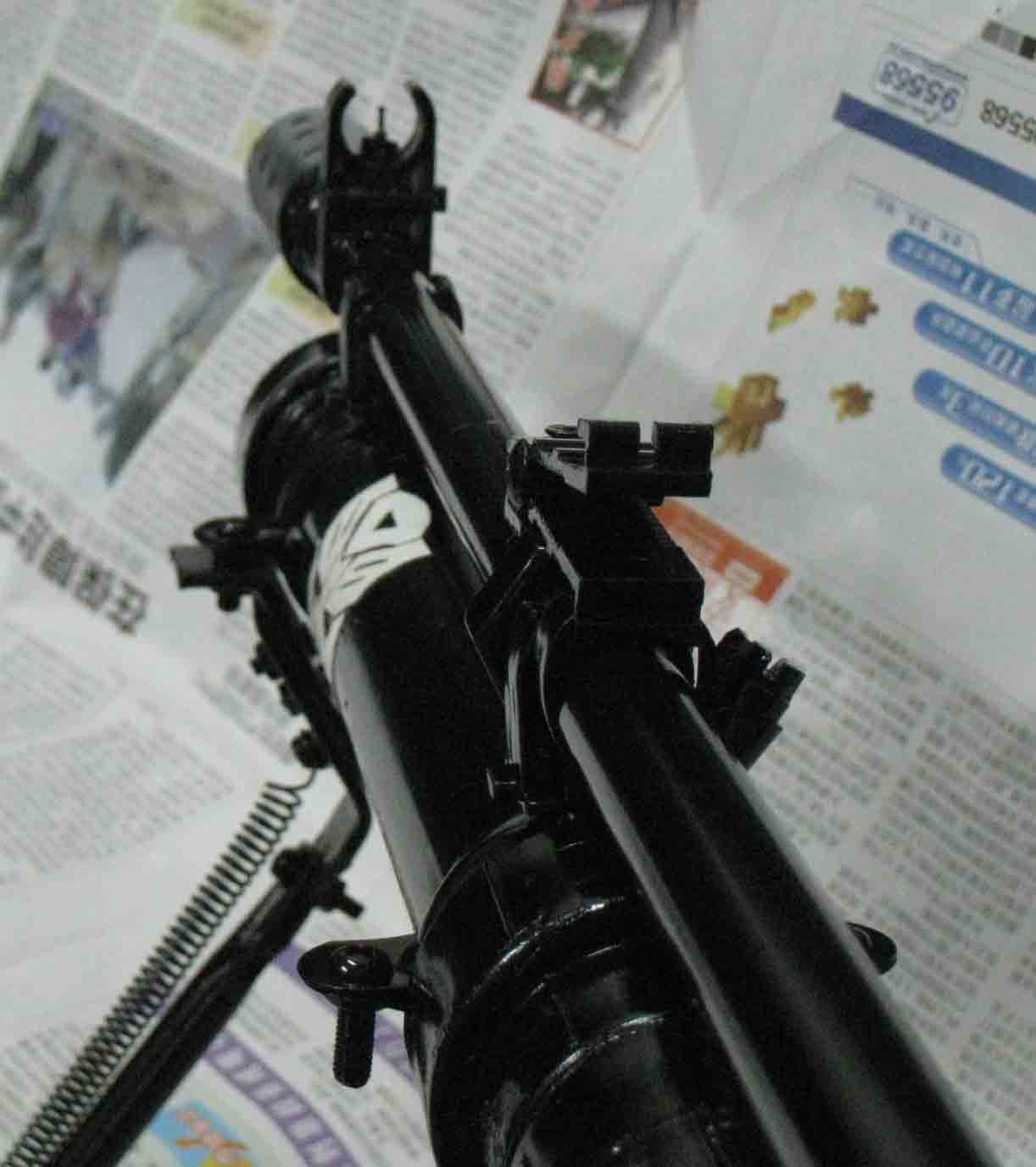

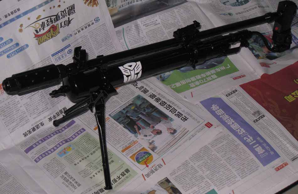

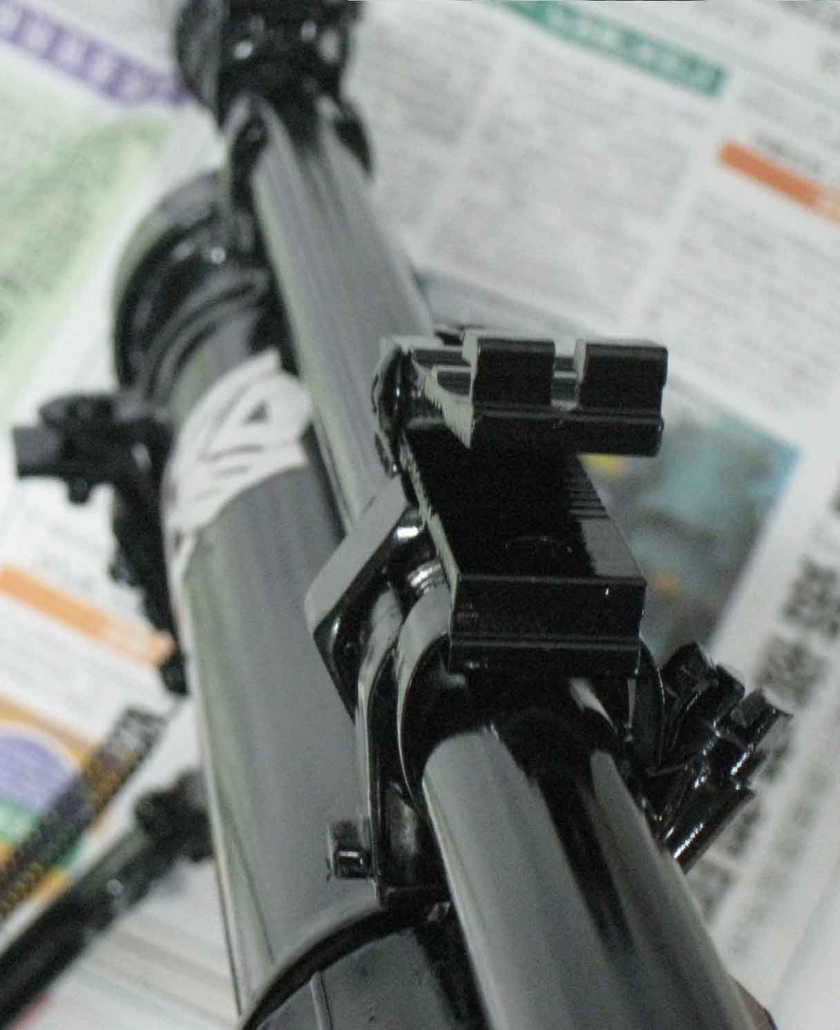

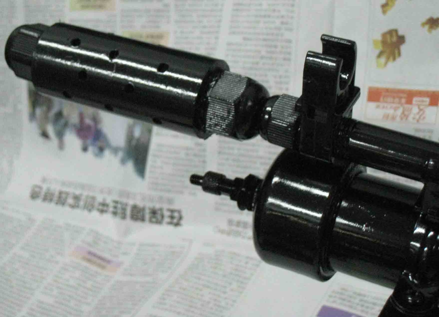

Looks nice, very well made. I like the sight and the PJ.
inonickname
Posts: 2606
Sat Dec 26, 2009 5:42 am

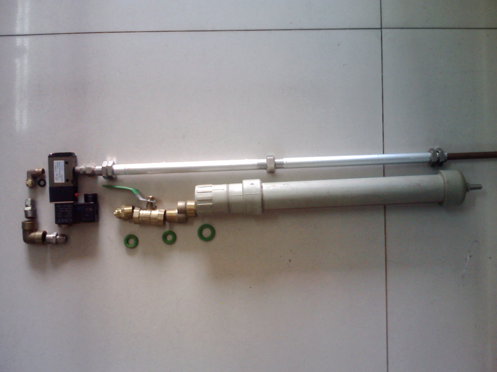

It looks very well made, same as your other gun. You have very good attention to detail and your guns are of high quality. However the small tube between the chamber and valve looks like a flow restriction that will be hurting performance.
Sat Dec 26, 2009 6:24 am
nice... I like it

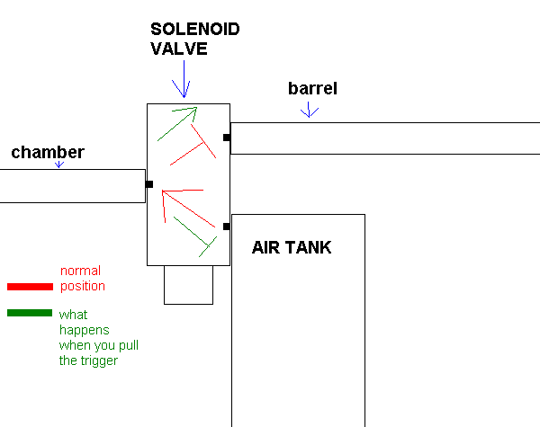

you could easily convert this gun into a semi auto and at the same time you could get rid of that ball valve between the tank and the chamber...
you'd have to use all 3 ports on the solenoid valve

inonickname wrote:It looks very well made, same as your other gun. You have very good attention to detail and your guns are of high quality. However the small tube between the chamber and valve looks like a flow restriction that will be hurting performance.
Pipe diameter φ8MM

wow very nice gun! I love the sights

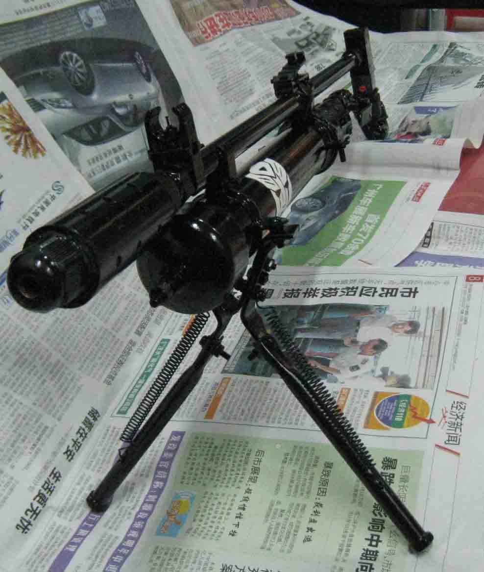

也想问,你是用 什么材料来建造这个汽枪?是钢铁还是塑料?我想知道你如何这把汽
枪做到这么仔细 - 是不是靠机器或靠许多工夫。

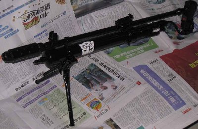

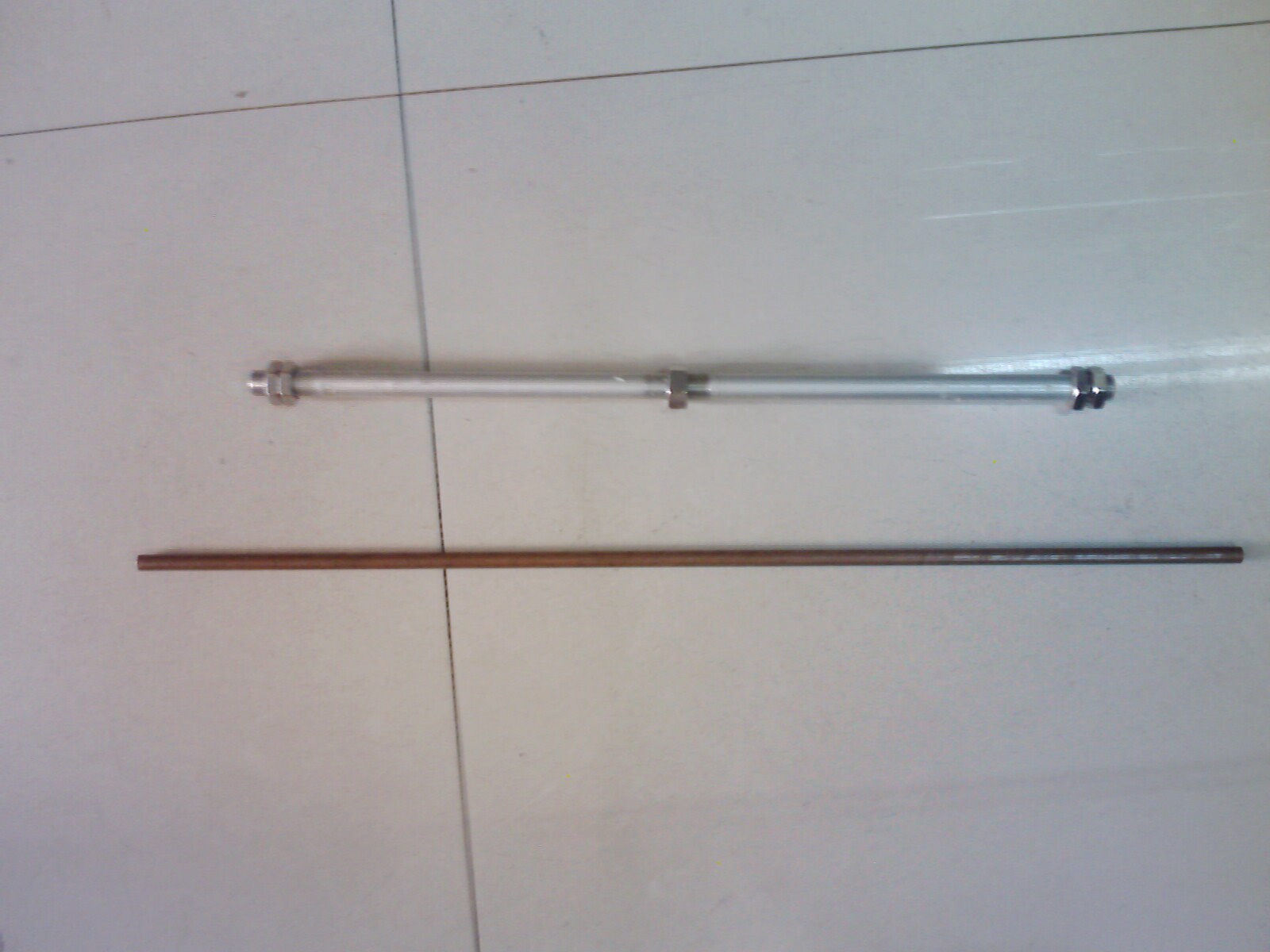

我来自温州,我现在就在闽南,这个吹尘枪是用PPR管做储气室,铜管做枪管,电磁阀做开关

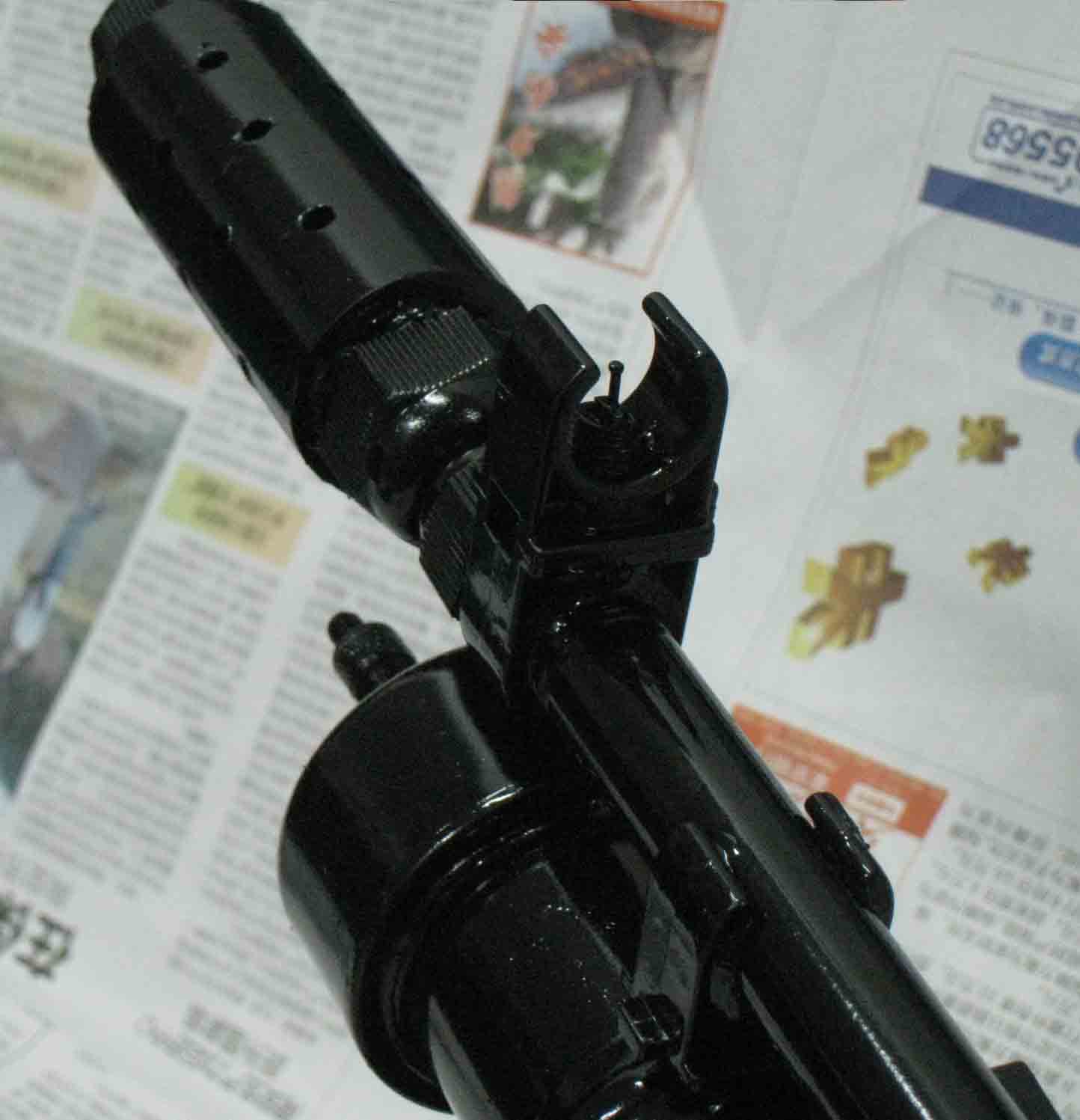

I thought the front sight had been lifted from an airsoft rifle, didn't realise you had made it yourself! nice touch :)
