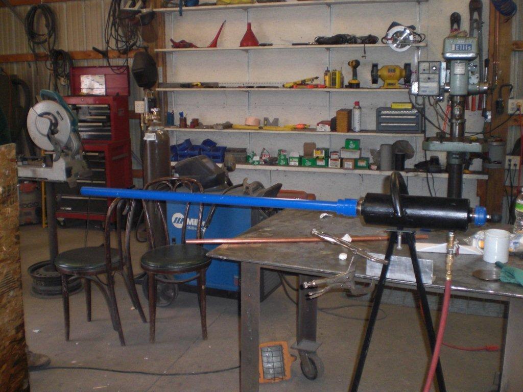

I was thinking about my grandkids’ marshmallow shooter, and started wondering "If you accelerate a marshmallow to a high enough velocity, would it be able to penetrate plywood?"
yep.

XP21 Thundersquish Tactical Marshmallow Cannon

Neat, but I'd point out that OSB is not actually plywood - it's rather less impact resistant than true plywood.
Still, impressive performance nonetheless. Any idea what kind of velocity you're getting?

Twizi: That is indeed a pvc barrel, pressure rated at 465 PSI. These shots were made with 160 PSI air.
Ragnarok: Yes, I know that OSB is not technically plywood, but it was the only thing I had in the bone pile at the time. My goal is to punch through 3/4" true plywood. -More on that as events unfold.
According to GGDT, the muzzle velocity is around 850 FPS and the KE is approximately 175 ft-lbs.

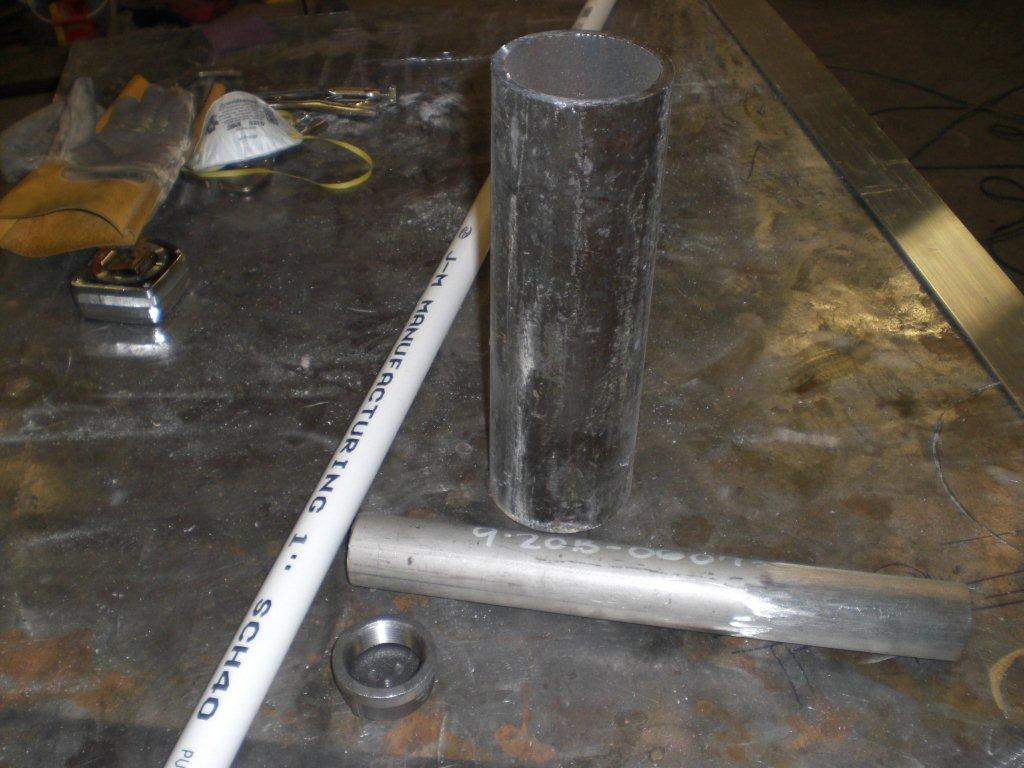

I did for the first one, but I have a machinist friend who turned this one for me.

Wish I had relatives like that as a childJohn Conklin wrote:I was thinking about my grandkids’ marshmallow shooter, and started wondering "If you accelerate a marshmallow to a high enough velocity, would it be able to penetrate plywood?"
Nice build, though is it really "tactical" before you slap on a few weaver rails and add a scope, laser and torch?

Extremely nice. I'd assume you've taken into account annealing weakening the material, but it all seems extremely well done. Looking forward to seeing more

Inonickname: You are correct. The steel being used is 50 KSI P&O steel, TIG welded and stress relieved per AWS qualified procedures.
Safety is always first & foremost in my shop.
