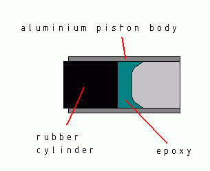

In my search for a light and effective valve for my upcoming sentry project, I've decided to give this configuration another go.
Instead of an all rubber piston, I put the rubber in a section of tight fitting aluminium tubing to eliminate any potential problems from the piston warping under high pressure.

What do you use as a piston material in your small-bores? How do you keep the sealing face bonded at high pressures? I remember being told that epoxy does not bond well to rubber...

Lately on my small bores I've been simply using solid rubber pistons cut from thich neoprene sheet with sharpened tubing as I did here.
In the case of the latest incarnation of this semi attempt (which didn't work by the bay, I misaligned the "barrel" - it's been bored out though so I'll repair it when I have time) the rubber sits inside aluminium tubing as in the diagram below so it bonds very well.
Another idea is to have a solid piston and have the rubber on your sealing face like on my mini-pistons.

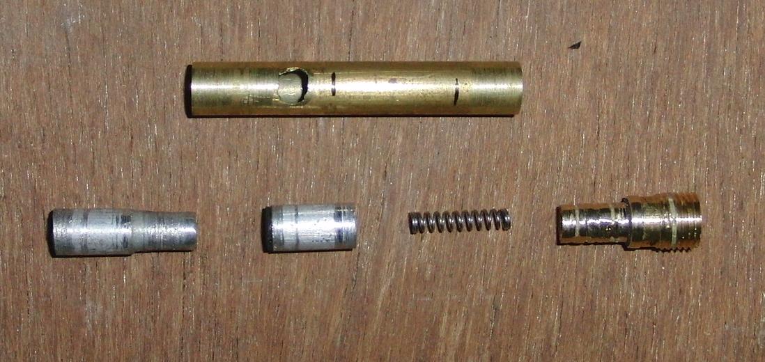

This is what I did in the mini pen-gun I talked to you about a few months ago.
It worked , but the space between the aluminium of the piston and the copper of the chamber was too big, and much more air would come out the schrader than out the barrel. The idea was to use very thin adhesive tape, one half-layer aroun the piston, and weapons oil to smooth the action. This worked fine, but the small power it had made me forget it in a one of my toolboxes
