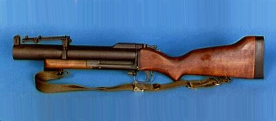

- Replicating this, more or less. the valve would be around the same place as the trigger on this one. The two 1" tanks will be contained in the faux stock, barrel will be the barrel, etc.

A QEV may work if hidden in the stock.

metalmeltr wrote:A QEV may work if hidden in the stock.
That's what I was thinking, and, granted, I have yet to go looking for QEV's that would fit, but the basic T shape will not work for the design.

After looking at it, I now see what you're saying. If the pilot is pointing up, with the QEV backed into the stock, I think I can still make it look like a continuous 1 1/2 barrel.
