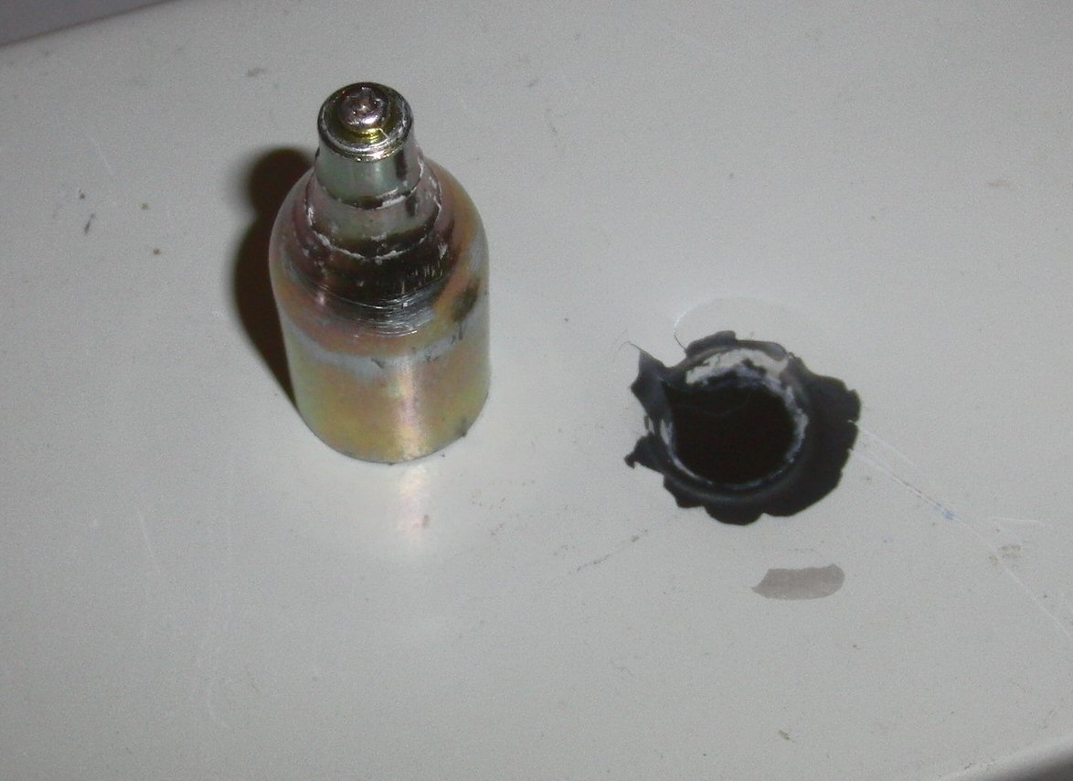

How well do the CO2 cartridges fly? tumble? I've seen others use them before, I think I might follow suit with my next build. They're uniform, destructive, disposable, and cheap (or free if you look hard enough). Seems almost too good to be true so me thinks there must be a catch; maybe a little lacking in the aerodynamic region? Maybe some little fins could be made and attached to them though. They'd look like wee little bombs 8)

They fly "straight" in the video because the target is only a couple of feet away from the muzzle, rather than using fins I think this is a better idea.

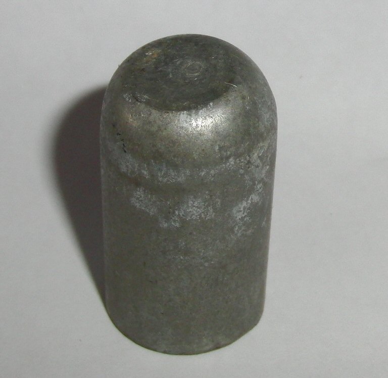

In the case of the barrel I'm currently using there's no need for a sleeve because it fits almost exactly. It's just a question of sawing the capsule in half and pouring something heavy into the nose. A good way for doing this if you don't have a container to melt lead in is to cut up some solder and heat the entire capsule, outdoors of course.
Here's one I made earlier, note the blunt nose from repeated impacts ;)
edit: Here's an round made with the opposite side for "armour piercing" effect, due to very poor sectional density it didn't go all the way through but made a nice enough hole in the 1mm steel sheet. A saboted dart would have gone through several sheets like butter, and I still have yet to turn it up to 800 psi...

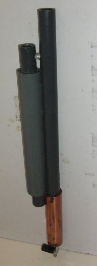

WIP shot, the suppressor is curing as we speak...

looks promising, how much power do you lose with that suppresor?
Sun Jul 11, 2010 8:25 am
Haven't quantified it yet, basically there's three 8mm holes spaced 2 inches apart starting 2.75 inches from the muzzle, feeding into a dual chamber suppressor with a volume several times that of the barrel.
I'll test it tomorrow when it's all cured.
