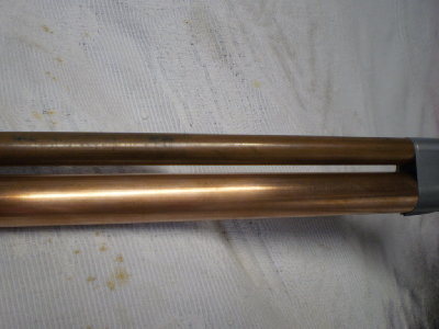

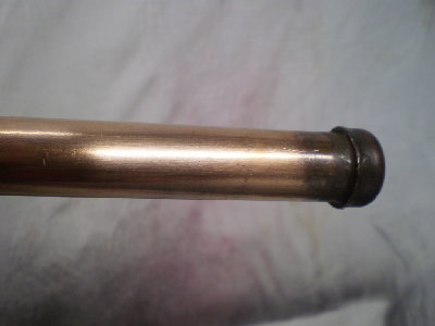

Hi, im building a 400+psi QEV bolt action copper rifle, with a oak stock.
4x32 scope. ammunition Holder, and bi-pod.
The gun it's self is about 60% completed and i just finished polishing the 3/4 copper chamber but the soldered weld's remain and i believe that
"If your not happy with it it's not finished."
So what would be the best way to remover them?
3/4 chamber with 1/2 barrel running alone length.
polishes 3/4 chamber with ugly weld's.

I only used steel wool and ran it from top to bottom a few time and it seems like it weld marks really don't wanna go.
And i want to finish it and get it on here a.s.a.p Because it So Beautiful.
