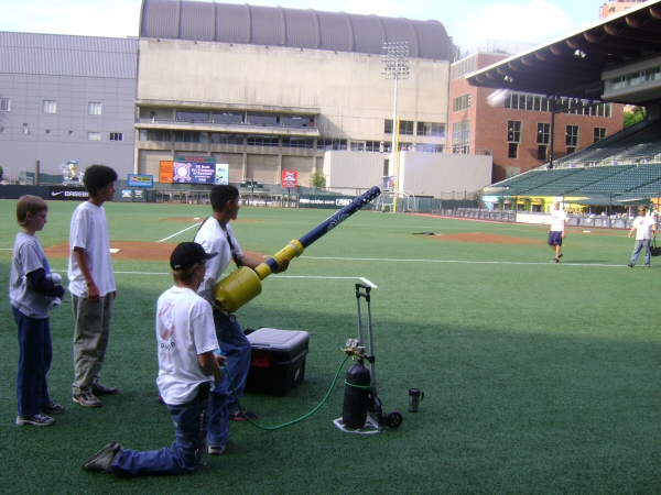

An alternative to a dive tank is a high pressure Nitrogen tank with a regulator. The school that built a QDV competition shirt cannon uses one as most sports arenas won't permit extension cords on the floor for the shirt cannon compressor.
Below is a photo of their set-up. The regulator is set to 100-150 PSI for quick fills, but they only fill to about 35 PSI using a gauge, as that is all that is needed.
