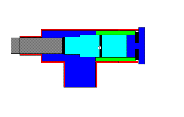

Try a slightly different design?
More info...and pics...can be found here;
http://www.spudfiles.com/forums/piston- ... 13478.html
Piston could be made from virtually anything round and nearly the correct diameter. o-rings are not absolutely neccessary for it to work either. Can be simplified to suite available materials.
				- copper gun valve paint resized.GIF (5.36 KiB) Viewed 4828 times
D&J: The pictures are in the links in my sig. Just click on them and look around. Any further questions about them, PM me.
