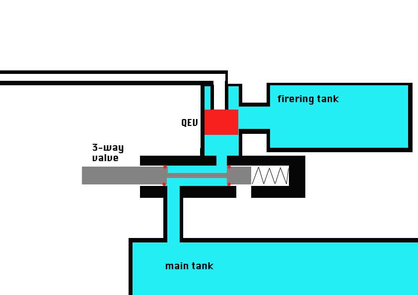

ok sorry, bit more on topic, i think this might suit your needs, all you need to do is figur out how you want to load it, and most of the stuff can be bought, its pretty much what i want to make but i have not yet devised a loading mechanism that i could use with the magazine stile i want

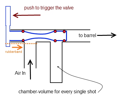

Aside from the off-topic and the mass of different diagrams of different valve's, I understood you in that way, that you are looking for a valve that:
-is just out of one unit (so no qev or other piloted ones.)
-will have enough flow/speed for small projectiles
-is capable of semi-auto-action
having this in mind, I would recommend you the following valve, it is basically a 3-way valve, that becomes unbalanced and use the "Tech's-QDV-style-effect" to force the valve open.
I use it as a piloted in this project, and it should work fine for small projectiles, at least better than a commercial 3-way (it has full-bore-flow, once opened).
the negative aspect is you will most probably make it on your own, but maybe I could help you with that if you decide to build one.[/url]

nature-boy wrote:the negative aspect is you will most probably make it on your own, but maybe I could help you with that if you decide to build one.
This is the issue I see here, understanding the theory is pointless if you don't have the ingenuity and imagination to use the resources at hand to flesh out the idea.

How the one you showed me works
nope it works exactly the way you want it. You pull the bolt back and air rushes through the side port into the barrel
basically speaking it is just like this design posted by JSR
But it has a separate port for the magaize

Remember the air will push on the face of the piston with high force when triggered open. Be sure the piston has proper limits to motion or you will be searching for it behind you.
